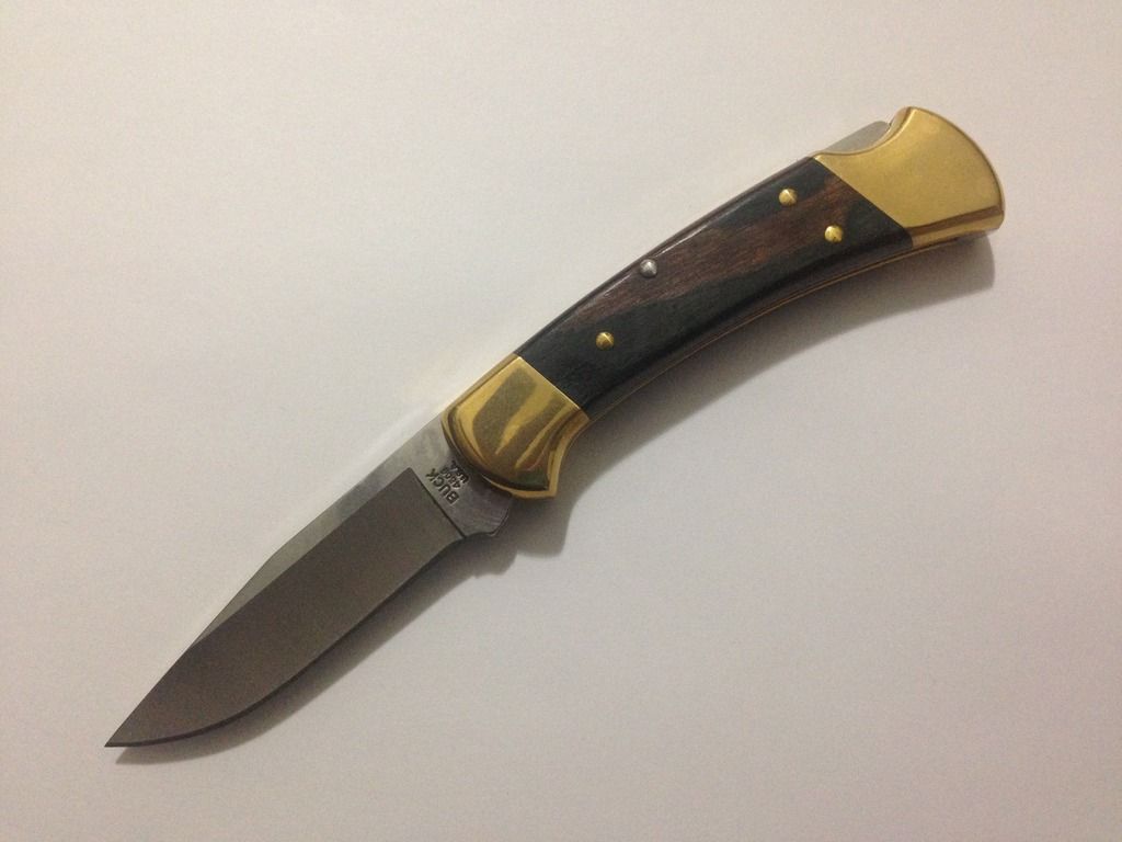

I like the lines of this 112/482.

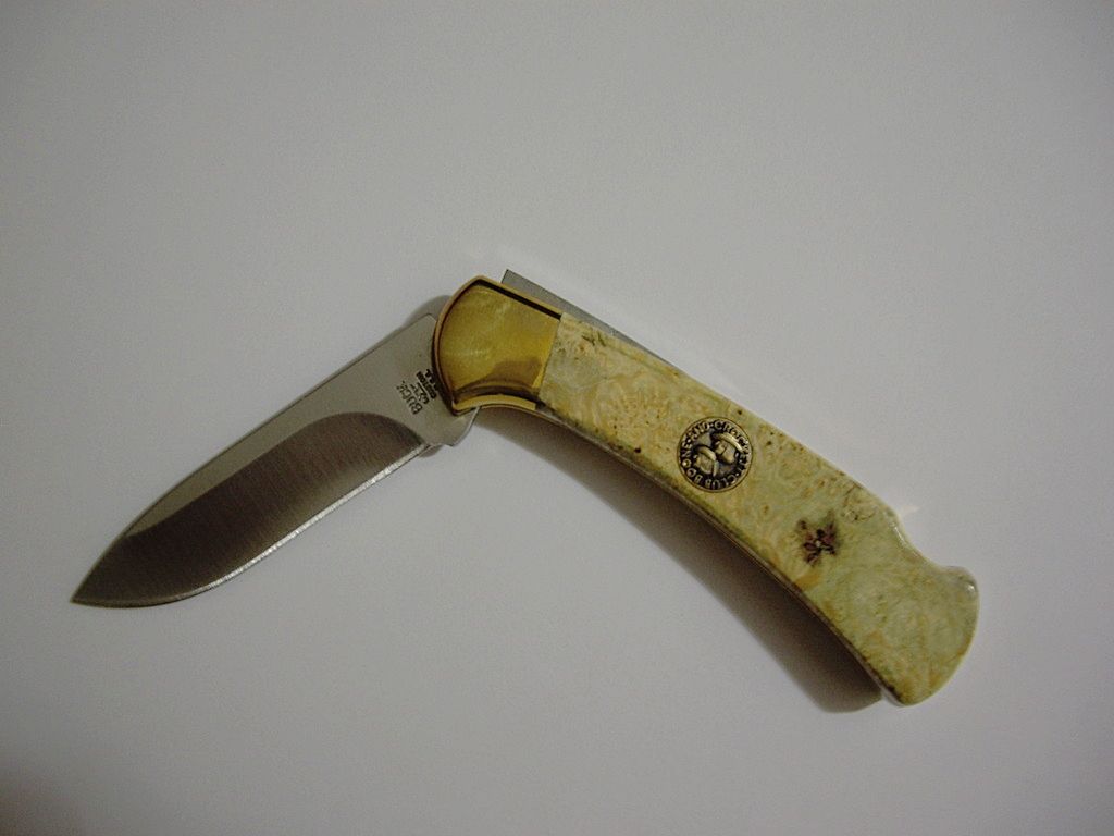

Some drop point blades the first one is a drop point with a radius grind
