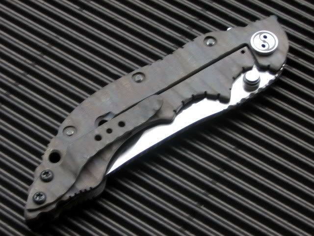

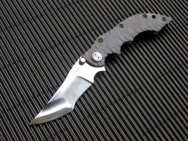

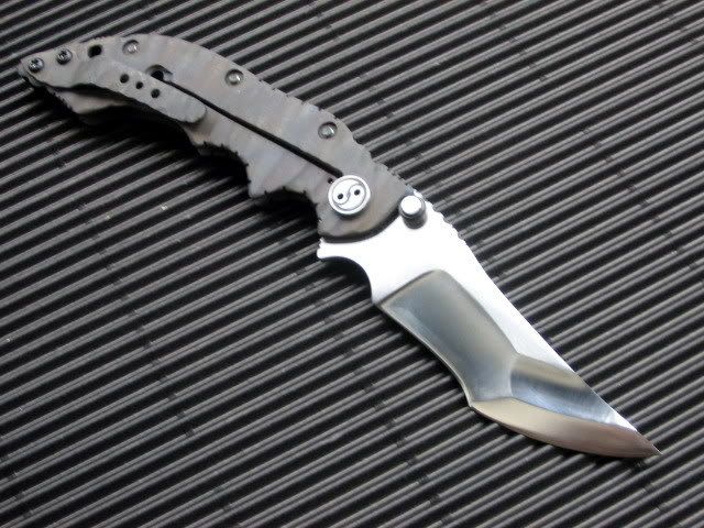

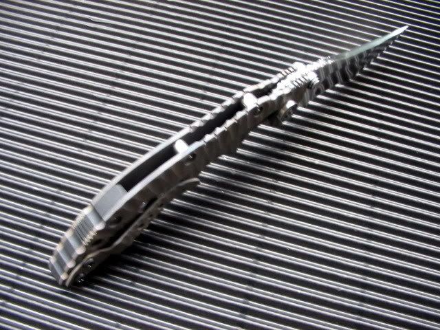

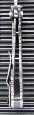

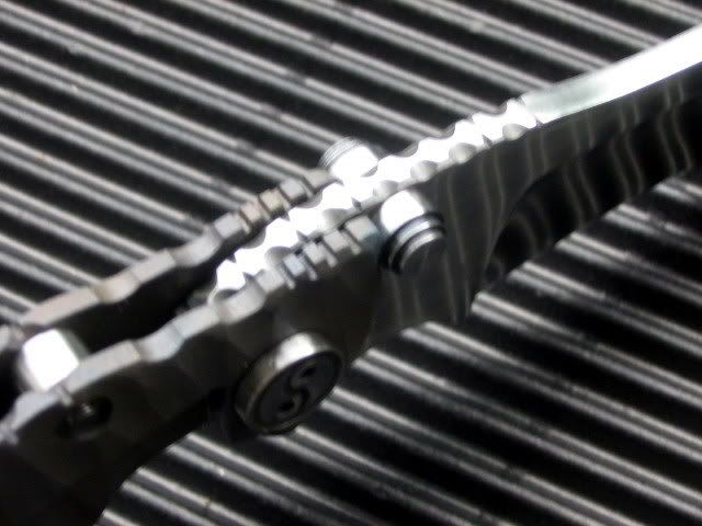

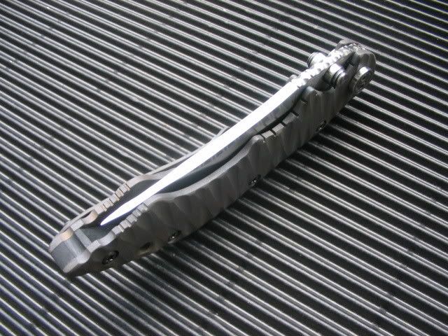

Trisak Joined Dec 18, 2004 Messages 753 Jul 12, 2007 #1 Hi all, Just finished! Assassin in all Titanium frame. Thanks for looking and comments.
Trisak Joined Dec 18, 2004 Messages 753 Jul 13, 2007 #3 Thanks bro. for all kind words. Sorry! I forgot to tell spec. Blade steel - ZDP-189 laminated with ATS-34, 64 Rc. hardness. Blade length - 3 7/8 " Opened length - 9 3/8" Thickness - 4.2 mm. Widest - 3.5 cm Frame - 6AL 4V titanium 1/8" thickness Pivot - Hardened 440C in Yin-Yan style. Washer - Teflon Thumb stud - Hardened SUH3 dual thumb stud ,
