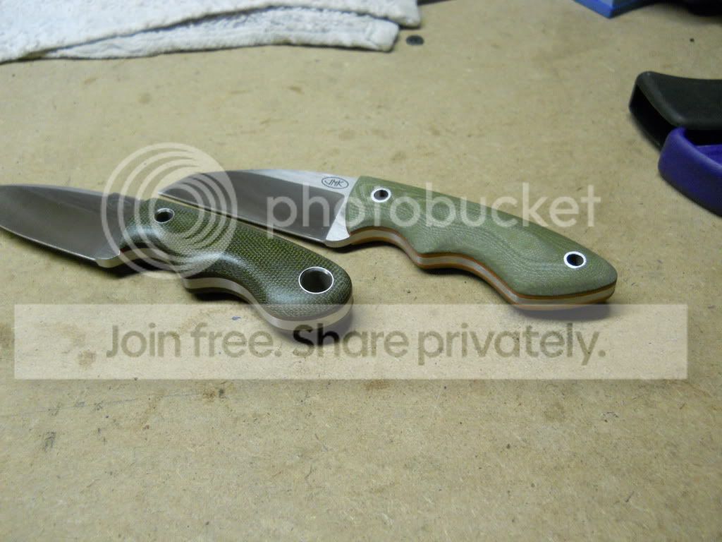

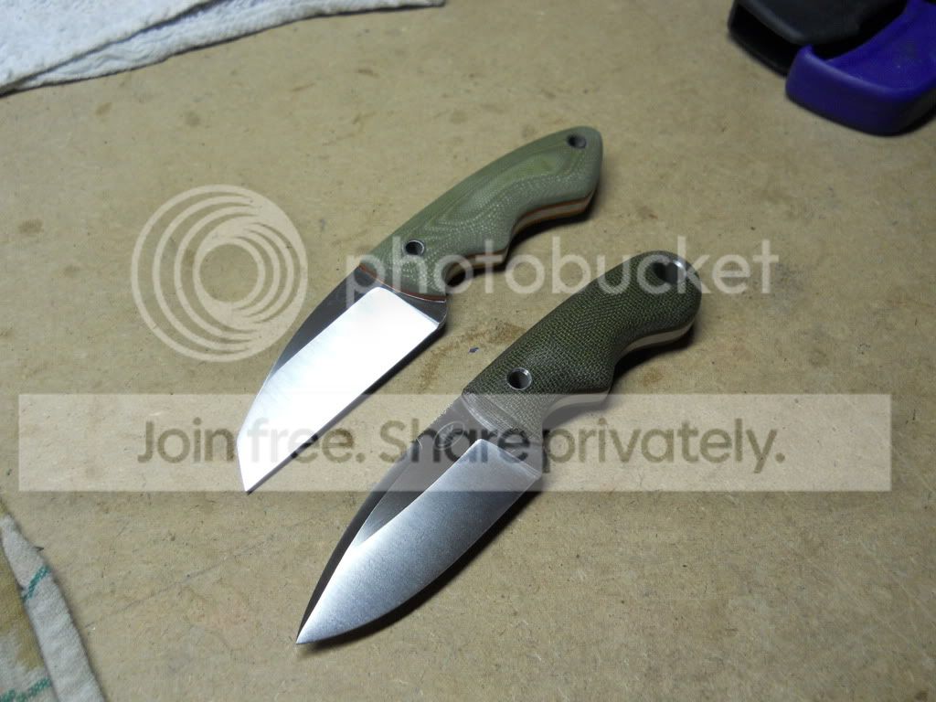

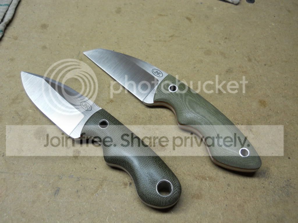

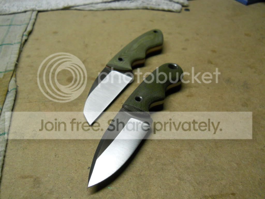

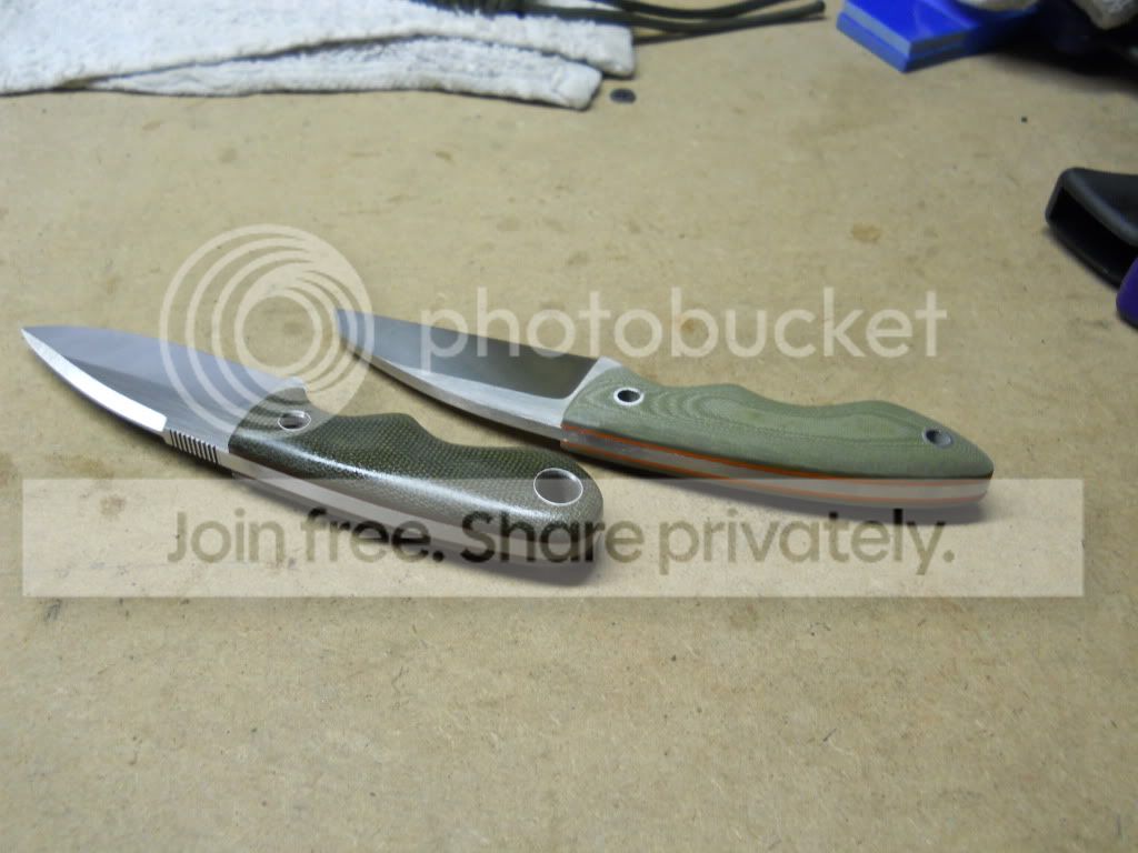

Got some orders I'm trying to finish with OD handles. The Mini Drop point is micarta with red G-10 liners and the wharnie is Chuck's two tone OD G-10 from Alpha. The more I use this two tone OD from Chuck the more I like it. Really great look to the grain. Neither of these blades are finished, and both were wiped with tuf glide to bring out some color. I need to do a few more grits on each but they're getting there. I think I like the OD G-10 so much I might just save the micarta for customer requests.

Nice work - the micarta is shiny: how are you finishing it?
The knife isn't done, it's only been hand sanded to 180 grit so far. I just wiped it down with a tuf cloth to brighten it up for the pics and bring out some grain of the canvas. This one is only going to be done to about 600 grit wet sanded by hand and no buffing. The customer wanted it to be on the dull side.

Chuck's two-tone looks really good. I would be interested to know if you find that the micarta is grippier than the G10 when wet. Talk to you soon.
Erik
Erik, I think the micarta is a touch grippier, but not too much. Texturing would change everything, but I find that a 400-600 grit hand finish without buffing makes for a good work knife that has pretty good purchase. Every once in a while I'll wipe the handle down with either Tuf Glide or Renaissance wax to bring the color out.

Love them! Especially like the wharncliffe... dont know why but it's just awesome.
Have you flared the stainless tubing on the drop-point? Kinda hard to tell from the pics... would love to do that to one of my knives instead of just straight pins.
