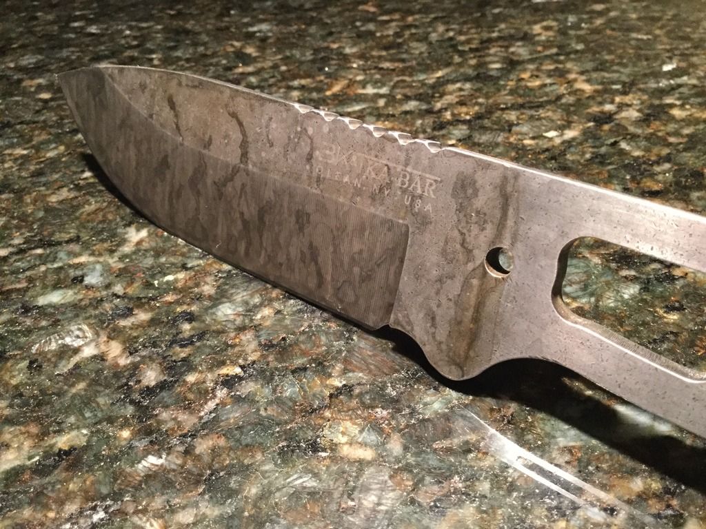

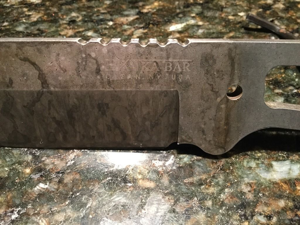

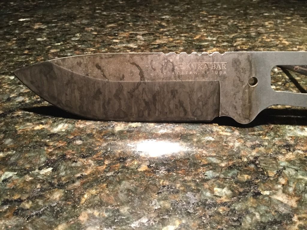

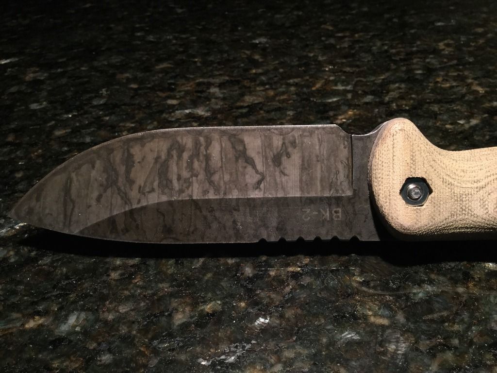

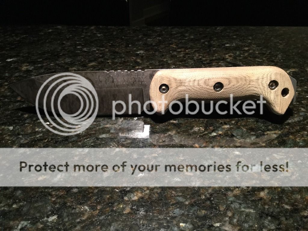

Here she is dressed.
I used citristrip to remove the coating, added jimping with a hand file and then with carbide tip on Dremel, same with the choil, put a 90 on the spine, 6 layers of chipotle Tabasco for the patina, black tea dyed the micarta scales and upgraded to stainless hardware. I received lots of insight from posts and pics on Blade Forums, so thanks you guys for the inspiration! I have another bk2 and a crewman in the box waiting for a makeover.

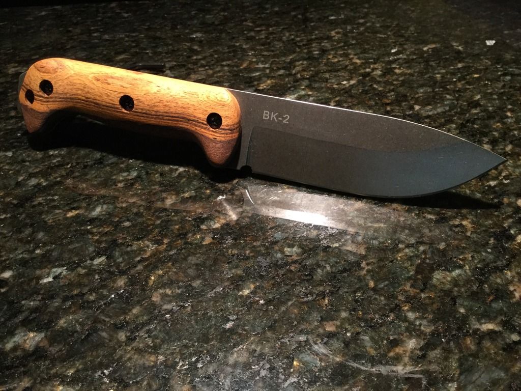

Here is my other bk2 stripped with custom Bocote handles. I probably won't patina this one. I'm undecided what mods if any will be made to the blade.

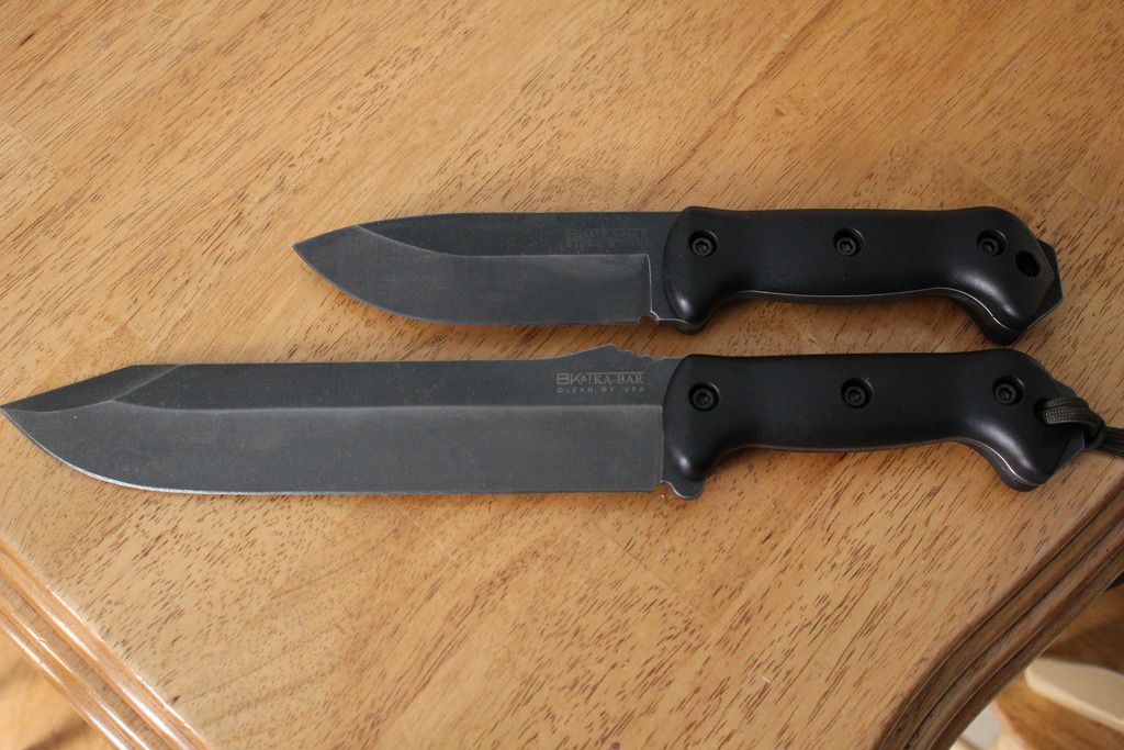

Here's what I've got for now. I like keeping the laser(?) branding on the blade instead of a full polish.
Thanks for the side by side of the 2 and 10 wrangoslash. Did you add the grip spacers to the 9? How do you like the thumb ramp? Seeing your 9 stripped just made me wrap the 10 back up in the pretty Amazon box for a swap.
Just want to make sure you realize the photo is of a BK2, top and a BK9, bottom. No BK10 in that photo. I'll assume you mean the numbers I gave. No spacers as of yet, both seem to fit my not-so-large hands well. I want to give 'em a try in the woods first and see if the stockers work well for me. Some say they are slippery and others say they are just fine. I'm not into the whole stippling thing so it'll be hockey tape or Gahhh!, Micarta ($$$) scales. If you can afford to keep the 10, I would. I think the 10 is probably a better choice than the 2 but that BK9? Oh baby! DO get that one! My field trials will tell if the 10 is more appropriate than the 2 as a companion knife to the 9 when the time comes. I'm having a hard time NOT buying every BK knife available right now. I hate Amazon! I'm such a knife whoore!
