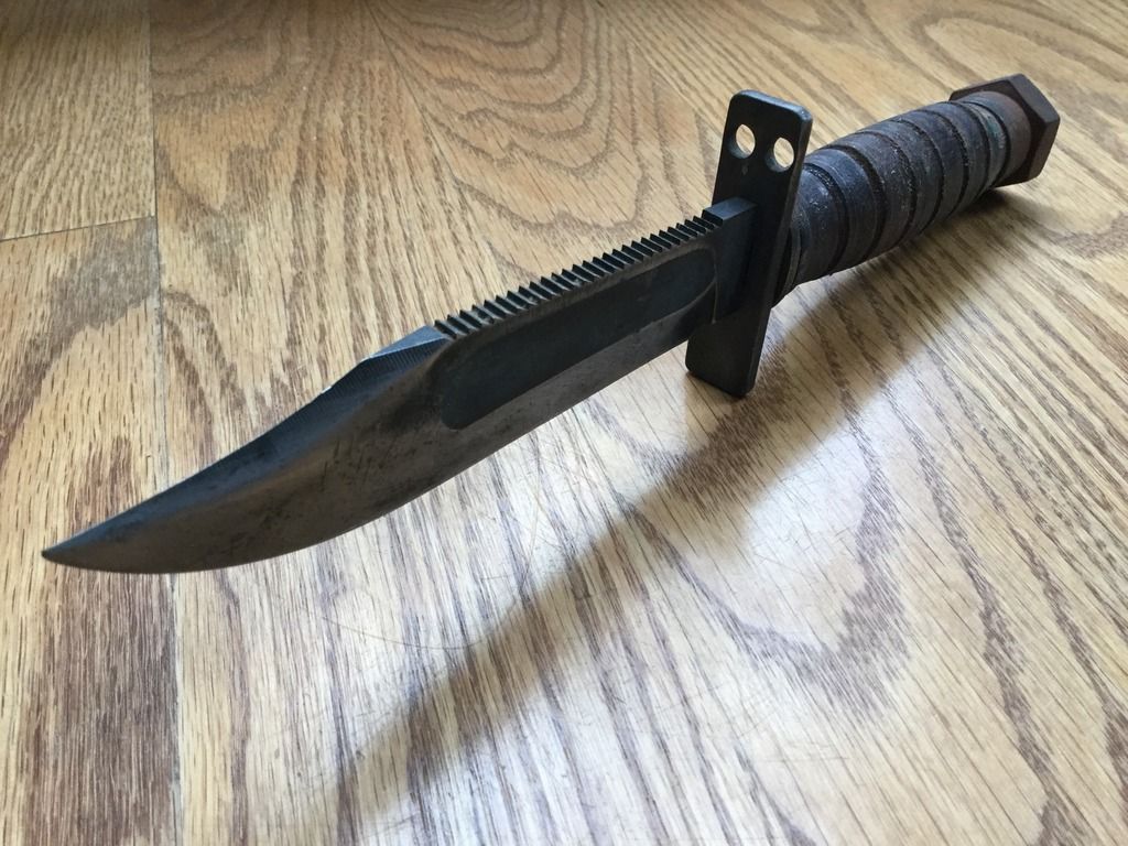

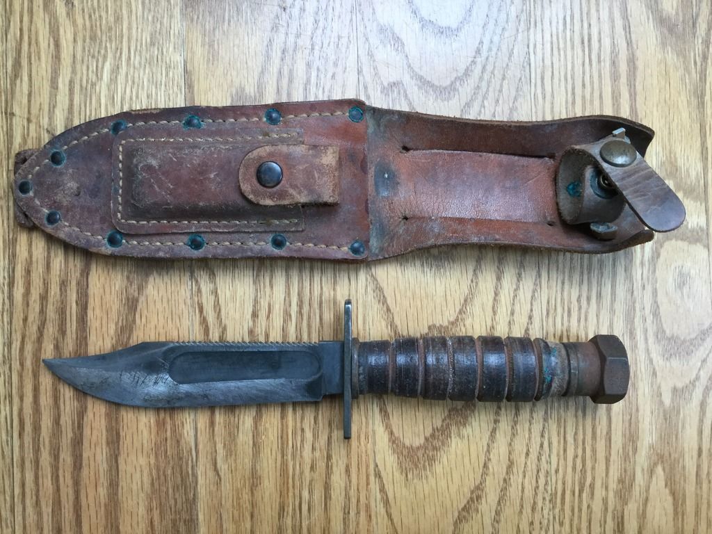

I use 0000 steel wool and 3-in-1 oil or mineral oil (which ever I have on hand) for removing any rust.

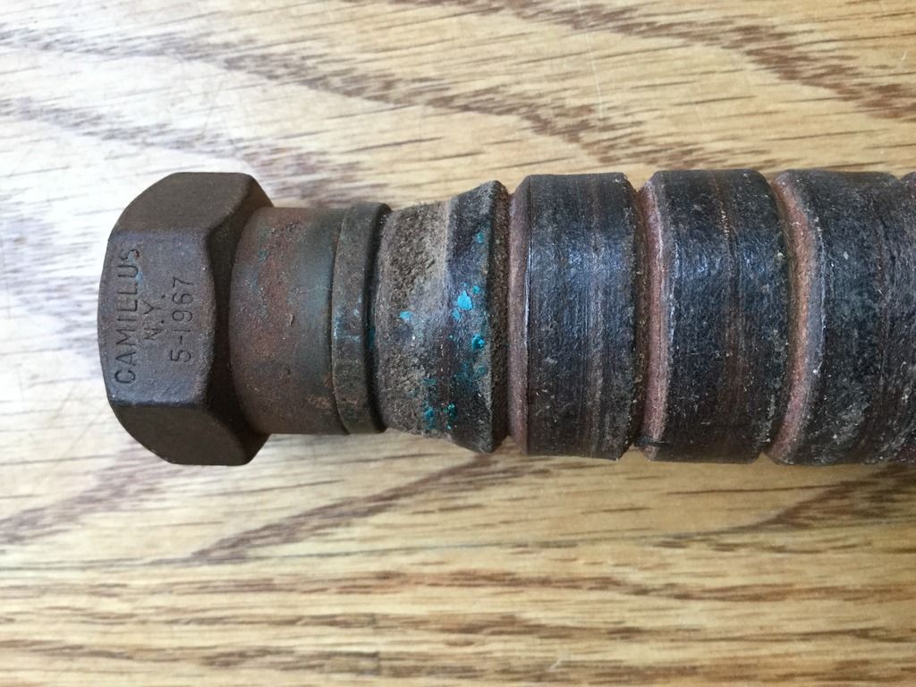

I use white vinegar and a cotton swap (Q-tips or generic equivalents) to remove the verdigris (greenish "copper rust" caused by the brass snaps/rivets). Then I follow the "vinegar wash" with a baking soda/distilled water solution (again using cotton swabs to kill the acid in the vinegar on the leather than gets dampened with the vinegar. Then I use plain distilled water to wash off the baking soda solution.
I use Obenauf's and a heat gun/hair dryer on low heat to melt and rub in to the leather, both handle disks and sheaths.
