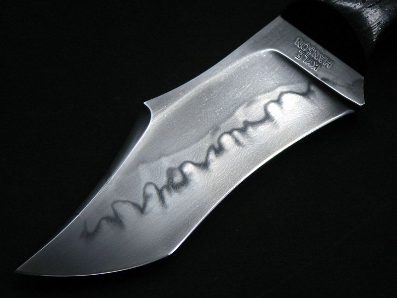

I'm no pro on this topic either, but I've seen similar effects on a lot of my knives. There is a distinct 'pattern' like very fine random damascus. It usually can only be seen when etched and is mainly above the hardening line on clay quenched and differentially heat treated blades.

I see some damascus like pattern in almost every blade we etch here, usually subtle. But nothing close to the damascus like pattern in the W2 blades I've posted. I'll see if I can find a photo of one of the others.

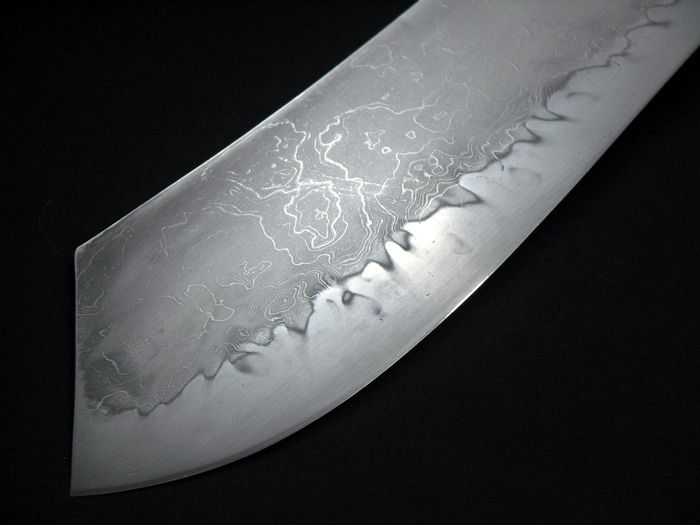

For those who didn't see the blade in the other thread, here it is:
[/url]image by Wjkrywko, on Flickr[/IMG]
If you zoom in, you can see the pattern quite clearly above the Hamon, it's more broken up below it, but the pattern is there at the tip. It's a swirly sort of random pattern.
This blade is from the 'clean' W2 and shows a very fine wootz like pattern. I can't find a photo of one with the fine random like pattern, it's hard to pick it up in a photo.
Don, the banding in your old stock was mentioned in the article. That steel likely came from the top center, the last point to freeze at the mill. He said this type of banding will not be broken up at forging temps or through normalization. The other type of banding like my HB2 blade and the last pic you posted are caused by our cycling of the steel. We can erase these through high enough heat. Your old steel is caused by primary carbides, where our subtle banding is caused by secondary carbides.
