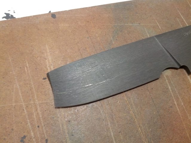

Hey guys!
I'm finishing up a batch of 7 blades at the moment, all made from A2. The steel is from 2 separate suppliers and I'm seeing alloy banding in both batches of steel. One lot of steel (bought a sheet!) was from Starret, the other lot was from Jantz Supply.
Here's a picture of the banding, I acid etched the blade in ferric chloride to make the banding more obvious:
Don't mind the abused and poorly finished test blade!
This banding barely shows up even if you look closely when the steel is satin finished, but it's obviously unusable for an acid etched finish.
Anyone else seen this in A2? Is this an issue with A2 from all manufacturers? I would have thought Starret would be making pretty clean steel...
Edit: it should be noted that I can see the banding both before and after heat-treat, so I don't think it's something I'm introducing.

The patches look to me like areas of higher chromium concentration, I don't have a microscope good enough to do any better than that kind of guesswork unfortunately.
As a a quick follow-up: I just talked to Starret USA about this issue, and they're getting me to send in a sample to they can section it and have a look. The guy I talked to seemed helpful, so we'll see where it goes from here.
I'm going to have to do more testing on a sacrificial blade and see if the banding is having any functional effect on it's properties.
I stopped using A-2 years ago because it almost always had alloy bands. I thought it was just me and my HT.
It probably didn't matter much in the blade quality, buy was a detraction in the looks.
I switched to 154-CM and then to CPM-154 with no problems. I know A-2 makes a great blade, and maybe there is a difference between suppliers. Mine was from Mick Koval, IIRC. ( Or maybe from Admiral??)

Thanks for the input Stacy.
I guess that's good news and bad news. Good news in that likely I don't have steel that's unusable. Good news in that I'm likely doing nothing wrong.
Bad news in that I may have to find a new steel. We'll see I guess.
I spent the morning on the phone with Starrett USA, and also with a metallurgist from the Canadian office of Uddehölm. The guy from Uddeholm said that he hasn't heard of issues like that with A2, but as he pointed out that doesn't mean it didn't happen, just that it possibly wasn't a problem for other users (who are possibly less demanding than we are in terms of aesthetics).
