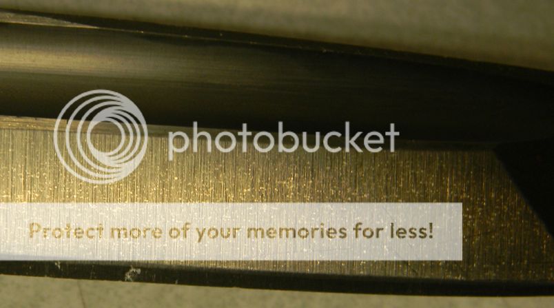

I was asked to etch some Latrobe A2 for comparison. This was still wearing color from heat treat except the grind on the bevel.
a2.jpg~original
Those black stripe things on the bottom right that look like scratches are, in fact, scratches. I was cutting cinderblocks with it.
This was etched in hot vinegar, I don't have ferric chloride.
It appears to me that this particular batch of Latrobe A2 might have less alloy banding than the OP.
Thanks for taking the time to do that Nathan, greatly appreciated!
The banding I see in the photo you posted looks similar to what I saw in the Uddeholm A2, the banding in the Starret A2 was longer, like lines as opposed to dots.
