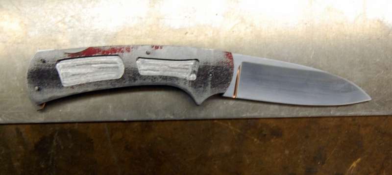

I have dove into interframe lockbacks, it has to be one of the coolest ways to build folders. I am at a friends shop using his Pana Mill, mine will be done at the end of the month.
I am trying out this design its a very stout hunter skinner? little over 7 1/4" long and it will have Iron wood inserts.
Later on I will try some smaller gent style folders, with more exotic inlays but for now this will work just fine
The start of the pattern building process for the pocket and the inlay patterns that will enable the pana mill to cut them out so the fit is perfect.
I will post up the finished knife soon
Thanks
Spencer

Here is the finished product, maybe after I get my mill I will do some kind of tutorial.
Thanks
Spencer
CPM 154 blade 3 1/4" a modified wharncliff I think?
8" open 4 3/4" closed
416 SS inter-frame handle with Ironwood inlays
Hand satin finished blade and mirror polished handle ( I plan to change the finish to a all over satin unless engraving is going to happen, also a lanyard hole will be added.)
Thank
Spencer

i woul love to see step by step process! also,did you ht the blade before you ground it? it looks like it just came out of the forge in the 1st pic.thanks,willy
Willy, I prefer to grind my blades after HT I have found that it really works better for me. The steel has a better feel to it hard and responsive vs soft and mushy. It also allows for the grinder to take it straight to finish vs grinding then in the oven and back to grinding, once I am in the groove I get consistent results.
On large blades its very wise to remove material or you can certainly burn through some belts for sure. It will be some time before I can do the whole step by step thing and for sure make no promises
Thanks
Spencer
