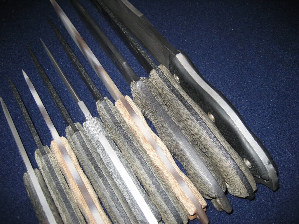

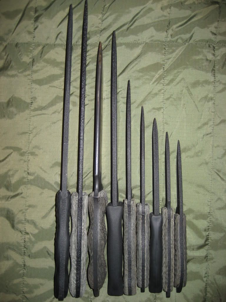

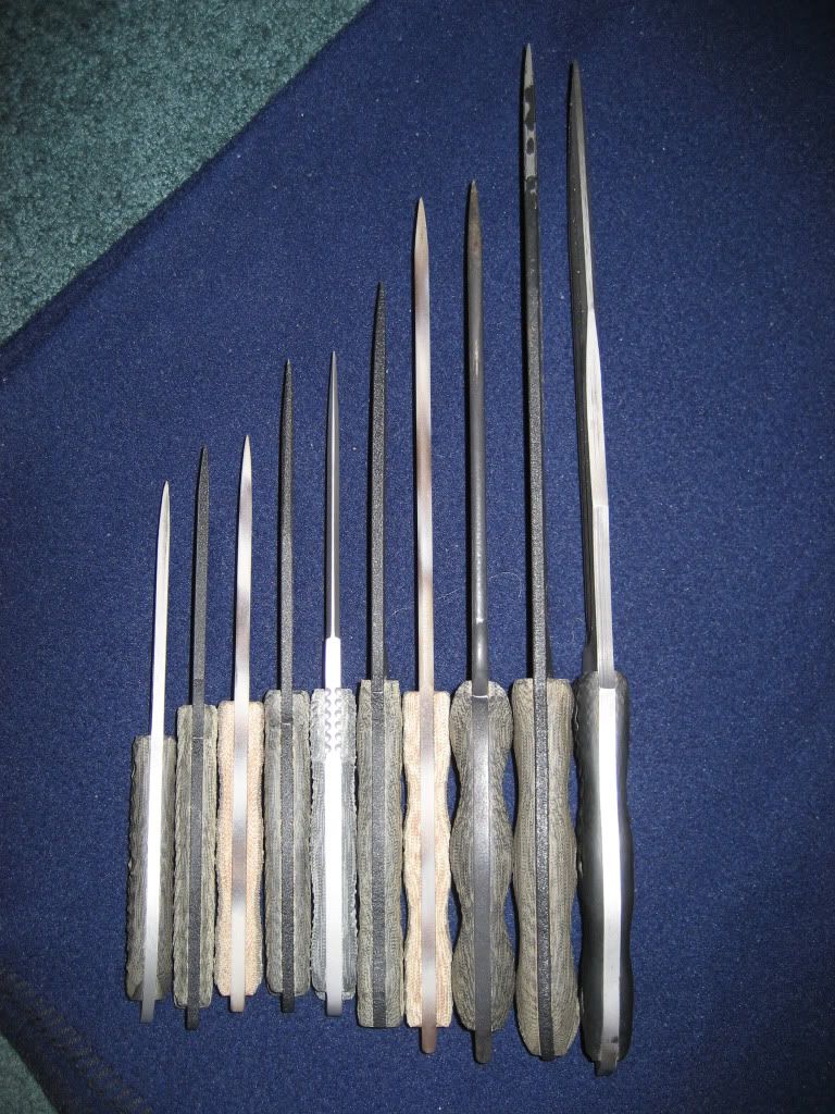

Here are some pics for ya to look at.......mags (NMSFNO and BWM) and standard (CGFBM).
Enjoy!
Mostly the difference is being about 1/4" thicker at each of the tube fasteners on most models. The areas in between are about the same as you can see with the layer lines in these pics.

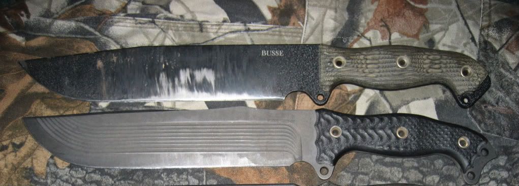

Magnums on .319 thick FBM LE
Handshaped on .275 FBM
Standard thickness fusion handle on .265 thick NMFBM.
Ok so the mags are simply more bubbled at the swells? BTW thank you for all the replies! You guys are awesome!
