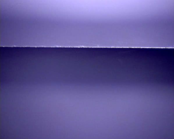

Here's some others you might like.
A glamor shot at 1 micron :D
I decided to finish a bit further at 0.5 microns and here's a pic of that edge at 400x. Still needs a bit more for perfection but its sharp enough :p

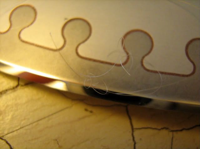

Pretty amazing pictures. Whittling hairs and then some. Is that CPM D2? Do you find that it polishes better than plain ingot D2? To me it seems like it does, but I rarely ever take any D2 to those levels of polish. Joe
Yep CPM-D2. Same here, both will polish but CPM-D2 polishes much better and the finished edge is much better. I usually don't polish it that much though but because of how it does polish so nice is was a good test subject for the photos. 1 micron seems to be a good stopping point going past that seems to over polish it too much, looses a lot of the bite/tooth.

To everyone that is having problems when getting a new finer DMT stone, Don't forget to take all the steps with the new stones that you use with your old ones. Once your scratch pattern is even use feather lite passes to refine the edge and remove the remaining burr. DMT stones cut so clean that at any grit you can have a edge with no burr as seen in previous pic's but you must work at it. Remember, lighter the better and using soap and water helps a lot, if your knife is not getting sharper with a finer stone then something is not being done correctly.

My OCD makes me bring knives to .05 microns, but M4 takes the highest sharpness with it of any steel I've ever tried. Out of common folder steels ZDP and CPM D2 seem to like my OCD polishing sessions the most after M4. As you said with practice and proper technique straight off the stones there should be no burr. The great thing about M4 is it is just as happy taking a very sharp but toothy edge off of the DMT coarse (shaving without a hint of pulling at yoar arm and getting hair above the skin with my Krein custom) or going all the way out to .05 micron with just unreal sharpness progressing from stone to stone. I look at my knives at 100x when I sharpen (I would love to have your optics and camera gear!) and some steels just can't take an edge beyond a certain point as I believe carbides start tearing out or the steels just plain microchip, but M4, ZDP, and CPM D2 are all pretty good about getting a consistent, burr free edge with none of those tiny microchips or carbide tear outs I sometimes have seen.
Great tips on the soapy water with DMT X fine as well, and the tips on breaking in the stones along with letting people know the importance of very light passes to leave a burr free edge right off a stone. My DMT's and Shapton Glasstones are excellent about leaving burr free edges with proper technique, my ceramics are less forgiving but it is very possible unless I am using Super Blue, all hard M2, or sometimes ZDP where those ceramics will microchip or burr steels that are cleanly cut with diamonds or waterstones. Your 18 years experience allows you to make wonderfully pretty and sharp edges, where my 3 years of OCD gives my decent looking to sometimes pretty edges (i used to not care how the backbevel looked at ALL) that are usually pretty darned sharp, a lot of times in short order because of microbevels. I would love to see you try some Shapton Glasstones to compare to your DMT X fine and XX fine, as they are WAY better than any other waterstone I have tried, leave shiny finishes (I mean VERY shiny at 1.84 microns/8000 grit) on every steel I have tried, and shouldn't gouge or give you issues like some of the first waterstones I tried. I know you are a DMT guy to the core, but after listening to those with lots of experience (and they did proper, long break in periods) they said the DMT XX fine just can't match the better waterstones like glasstones for 8000 grit finish.

Thanks mike, true the DMT XX-fine does not produce as good a finish as a 8000 grit waterstone but the level of sharpness from the xx-fine is out of this world. I would like to try one of those glasstones one day but I still need to complete my set of DMT's first, are the glasstones like a ceramic or a waterstone?
Surprisingly the camera I use is a kids toy, its called the Bionicam by eyeclops http://www.eyeclops.com/ its hard to get the pic's though I must use two flashlights on either side of the blade to get enough light. For the price and the quality of the pic's though its hard to beat.
