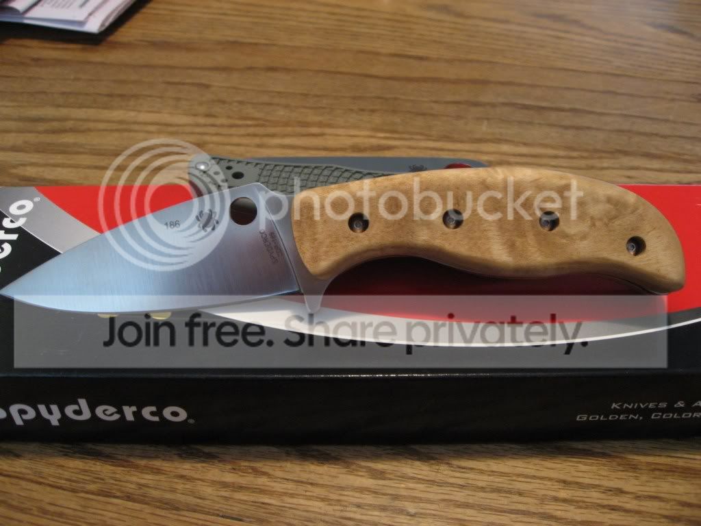

You can use threaded sleeves with button head or flat head screws. I liked the look and did it on this knife, but I epoxied as well, so the screws are for retention and looks only. It is not a take-down:
I know Tracy sells the sleeves under handle hardware and has the screws as well. If you could press fit the sleeves into place within the tang, the screws could be used to take the handle scale on/off. However, you won't see many knives that are set up to remove handle scales as it encourages moisture under the scales and corrosion. Most makers seal the handle by using epoxy between the scales and tang unless it is a purpose built knife.
