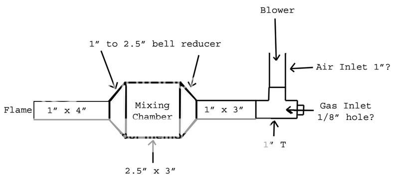

Stacy,
I'm a little confused as to what you are saying about the "mixing chamber" for a blown burner. All the ones I have seem use something like 2" pipe all the way to the end and is then reduced to 1" or so.
Is this what you are suggesting or did I understand you wrong.
Exactly !.....with some other issues.
The blower manifold should come directly into the burner tube, and the gas should come from the side. This cuts down turbulence. The air manifold should be twice the size of the burner, so in your diagram it should be 2". It can have a 90 degree elbow as long as it is in the larger diameter piping ,and 3" or more from the gas inlet.
The gas fittings are normally 1/4".
The nozzlel tube from the mixing chamber can be longer than 4" if needed to make things fit the forge shell. Actually, about 2-3" from the outer shell is good.

Do you mean a completely open 1/4" nipple for the gas inlet? That seems really big since my venture has a #59 hole in it.
So basically I can have a strait burner with the blower on one end going into a 2" pipe, then 4" later have the gas Inlet pipe, then widen to 3" and then down to 1" going into the forge.
Can I just drill a hole in the 2" pipe and put the gas inlet at a 45 degree angle. Then seal it with jb weld?

On a blown burner there is no orifice. Just a 1/4" ( or whatever size) nipple/valve screwed into the manifold. You use a needle valve to regulate the gas flow.
Many people tap a hole through the air pipe and thread in a nipple. It can be sealed tight with gas line sealant or tape. I would not use just JB weld to attach the gas inlet through a hole, though. The last thing you want is the gas line falling on the floor spewing gas out .
I'll try and describe the path in regular words.
Starting at the blower:
BLOWER>GATE VALVE>2" AIR MANIFOLD>GAS ENTERS FROM SIDE> PIPE DROPS TO 1"> 2-2.5" EXPANSION CHAMBER> 1" BURNER TUBE>FLARE
In engineering terms:
BLOWER CREATED AIR VOLUME>
GATE VALVE RESTRICTS FLOW TO DESIRED VOLUME WHILE CREATING BACK PRESSURE ON BLOWER>
PRESSURE DROPS IN MANIFOLD LOWERING VELOCITY>
GAS ENTERS AIR FLOW AND STARTS MIXING WITH LOW PRESSURE-LOW VELOCITY AIR>
PRESSURE RISES AS GAS/AIR ENTERS RESTRICTION AND INCREASES VELOCITY>
PRESSURE DROPS SUDDENLY IN MIXING CHAMBER AND GAS/AIR COMPLETELY MIX INTO COMBUSTIBLE CONCENTRATION>
PRESSURE AND VELOCITY INCREASE AS IT ENTERS RESTRICTION AND PREVENTS FLAME FROM BURNING BACKWARD INTO THE BURNER TUBE>
FLARE INJECTS GAS/AIR IN AN EXPANDING AND LOWER VELOCITY STREAM>
HOT CHAMBER IGNITES AND COMBUSTS GAS/AIR
