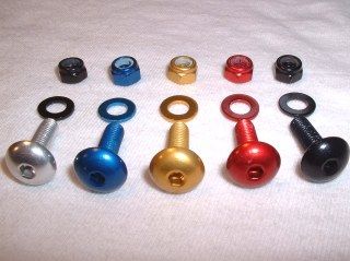

I don't know about how well one can patinate aluminum. There may be a range of colors, but I just don't know.
Aluminum anodizes into many colors...
