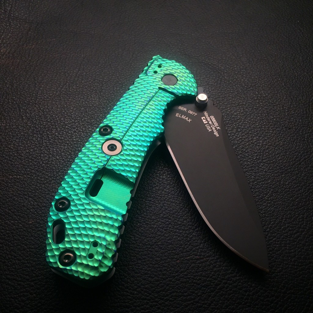

I'm having trouble finding a company (or individual) who's able to re-ano the scales for my Benchmade 13150 (HD Mini-Hardtail). I've made a few calls (left msgs, actually) to recommended anodizers, but none have returned my calls. Any help would be appreciated.
BM said the alum. is 6160 T6, silver ano, etched prior to the process (Type II, they recollect). The silver would have to be stripped before re-ano'd. (My knife is NIB).
I've got a killer, custom job in mind and the re-ano (light green) is crucial for the look I want to achieve. (Dark acid,stone-wash/green ano scales/genuine tortoise shell inserts).

I need to go from (factory) silver to green. Also, the area below the inserts needs to be bare, polished aluminum for the t-shell to pop.

Sodium Hydroxide would be used to strip the aluminum, it would need polished after its stripped to bring the finish back to factory condition. When a part is anodized it produces a layer of aluminum oxide, 0.001 thick. One half is in the aluminum surface 0.0005 and 0.0005 is added to the surface. This can alter fit slightly and needs to be taken into account if close tolerance is crucial. The finished anodized surface is aluminum hydrate after the part is sealed. Fred

The info is certainly appreciated, but I want to outsource the anodizing work. Any recommendations?
Also, green is just one of the possible colors I was considering. Additionally, the tortoise shell pic is not the piece I'm going to use. I have a nice stockpile that I've accumulated over the years to choose from. It is not illegal to work with. It is only illegal to sell. ...and I've found that gold foil produces a better effect than spray paint.
