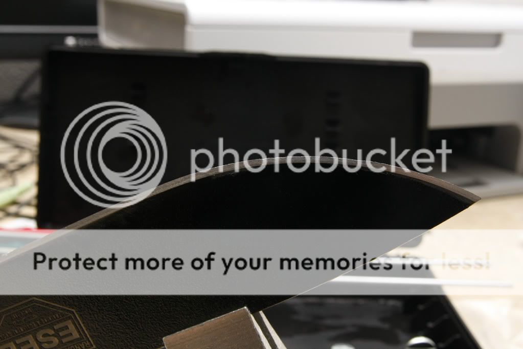

I basically beat the hell out of my knives for the ESEE contest. I'm just curious if this is normal for an ESEE knife. I've had it happen to my Gerber LMF II before (a much larger chip than these), but I don't know how common it is for an ESEE.
It's hard to see how deep some of the chips are here.
This is from chopping and batoning mostly. The picture was taken after sharpening (which I'm not the best at. I'm using a Lansky system.) The knife still goes through wood with no problem, so I'm not concerned, just curious if there may be an issue that could do worse damage later.
Seems the chips would sharpen out but I imagine it would take quite a bit of sharpening.
Did you hit the ground or stab it into the ground at all? That edge looks like it made contact with some small rocks.
If you "basically beat the hell out of it", that doesn't look bad at all for 1095. Batoning shouldn't do that but chopping can if you're technique isn't perfect.

What materials have you cut besides wood? That shouldn't happen if you are just "beating the hell out of it" against a wooden adversary. Judging by the scratches visible on the bevel you definitely hit something besides wood.

I definitely only cut wood. I believe the scratches are from using a coarse stone to see how much it would take to get the chips out.

On a side note: I managed to get the smaller chips outs and whittle down the bigger ones with a lot of sharpening with a coarse stone, as suggested.

Sounds like good progress! Now if you can start to feel a burr form along the whole edge when you are working that coarse stone, then you know you are forming a new edge. Then you can work your way to refining the edge on higher grit stones or other sharpening mediums, and you can hone it to razor sharp. Good luck!
Those aren't chips-they're dents/rolls. Arkansas stones are the perfect tool for fixing these, they kinda mush the steel back to their original position while removing bulk excess. Definitely typical for a mid to large sized high carbon blade, and they should buff right out. Your LMF2 is another story. I have one as well and that thing... the edge just falls apart with normal use. Chips and fractures everywhere, the blade is damn near useless. I battoned my RC5 through a log with a 16 penny nail hammered into it-you shoulda seen the dent in the blade... after about 5 minutes of work it was 100% functional again. That's the beauty of a quality high carbon steel versus these rediculously hard and brittle stainless steels.

Why are the rolls toward the tip? This is not the area that gets used during chopping/batoning. What were you doing that rolled that part of the blade? Regardless of what others say the edge should not roll that extensively if used as you say. I have a ton of experience with ESEE 1095 and while I've had some deformation of the steel along the edge I've never seen the edge rolling in your pictures unless I've hit something harder than wood.
