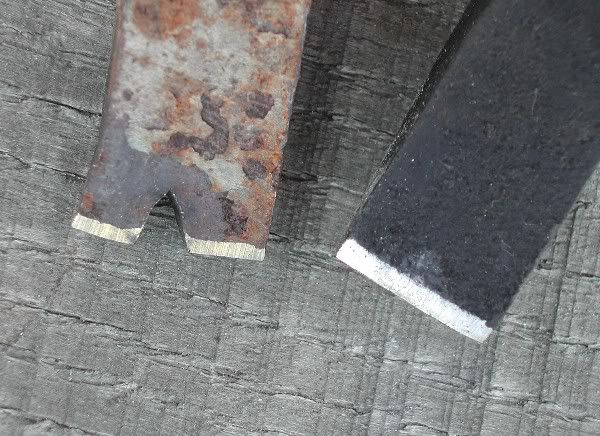

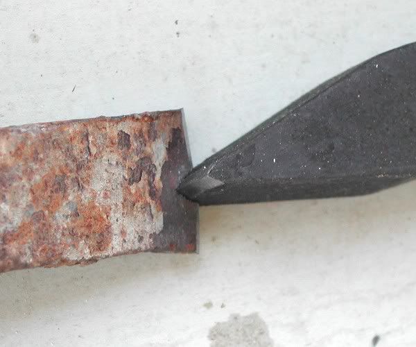

Unhardened spike vs. hardened spike:
(Makes a decent cold cutter.)
(Kind of toolish/foolish)

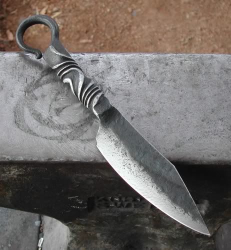

One of mine
That is real fancy Tai: One of these days if we ever meet I will show you how to develop my secret Penzoil Damascus RR spike blade.
Thanks Ed. I'd love to see that.
Oddly, I've probably gained as much or more recognition from my RR spike knives as I have from anything else... even canola. ;)
