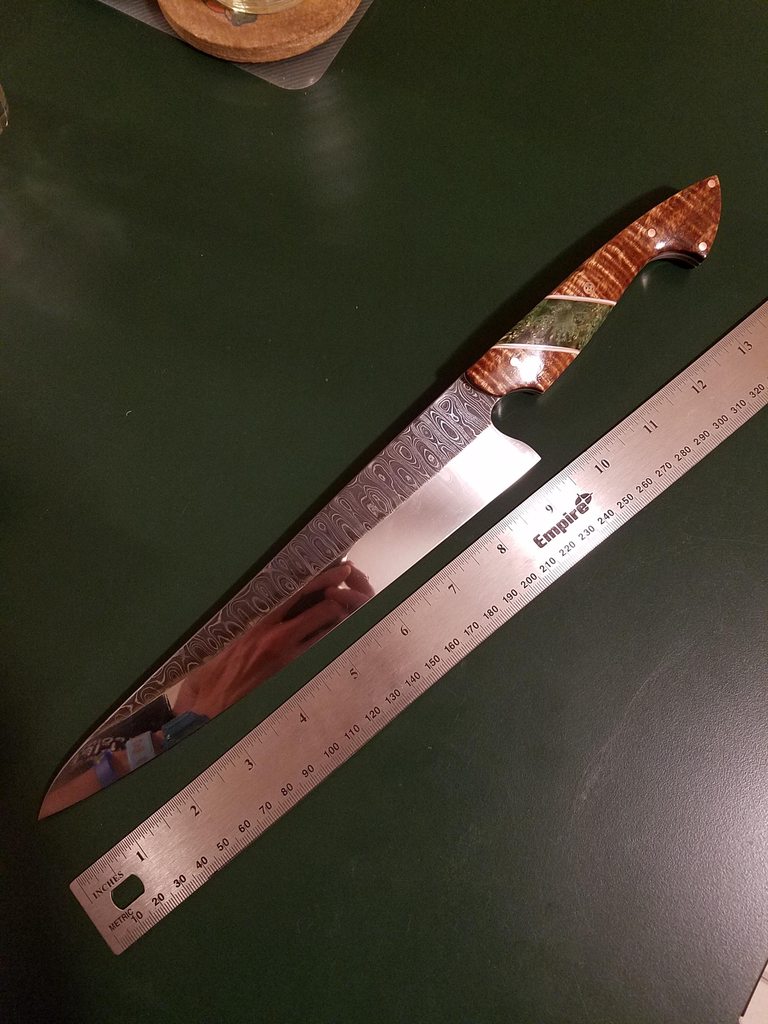

So for fixed blade knives that's around $300 to $400 or even less if you already got stuff like the drill press, sander, etcetera or just send out for heat treat instead of making a two brick forge.
You can make a crappy knife like the one below (imagine not in damascus steel and cocobolo handle tho) I finished recently with this relatively cheap equipment plus a lot of sweat and swearing.
