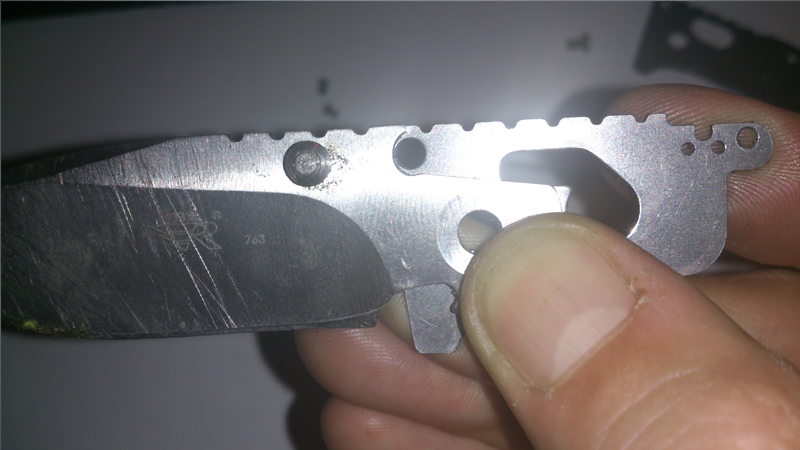

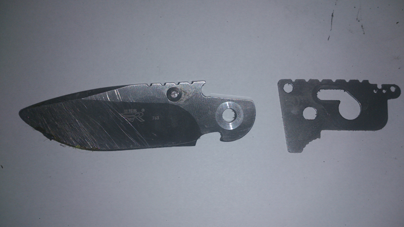

I took my cheapy Chinese copy apart to take some pictures and explain why I think this is the case.
As you can see on the piece of steel to the right the metal cut out for the lock bar is symmetrical/straight (excuse my English, it is not up to snuff when talking technical)
But, as you can see on the blade the cut out piece for the lock bar is cut with an angle.
The point of this is shown in the next picture.
As you can see the cut out in the blade makes it so the lock bar can't travel all the way to the left, the space for the lock bar to travel is getting more and more narrow.(there is no maximum decompression of the spring)
This means the lock bar will sit very tight between the blade and the handle piece.
I think there are several reasons for having vertical blade play:
- The lock bar can travel all the way to the left and therefore doesn't sit as tight as it should.
Which could be because the blade cut out isn't made properly.
Or the lock bar is to thin.
Or there is to much space between the blade and the stop pin so the blade rotates up thus making the space for the lock bar less narrow.
This is not just annoying (play is never fun) but effects the longevity of the knife greatly.
One of the best features of the AXIS lock is it is self regulating. When there is some wear in the lock bar or the cut outs, the lock bar just slides a little further to the left until it sits tight again. But when the lock bar is already all the way to the left it can't self regulate and the play will get worse over time. I think this constitutes as a construction error because it defeats one of the best features of the AXIS lock.
- The spring is decompressed to it's maximum to early so it doesn't travel left far enough.
Which could be because they used the wrong or faulty springs.
Also a construction error but one which is easily remedied. As long as you can get the right springs.
