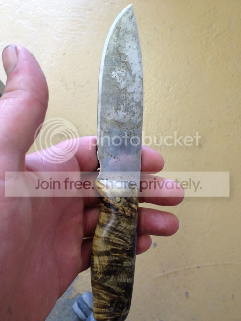

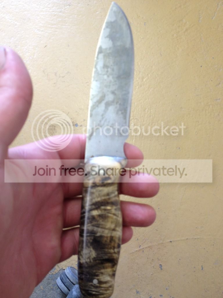

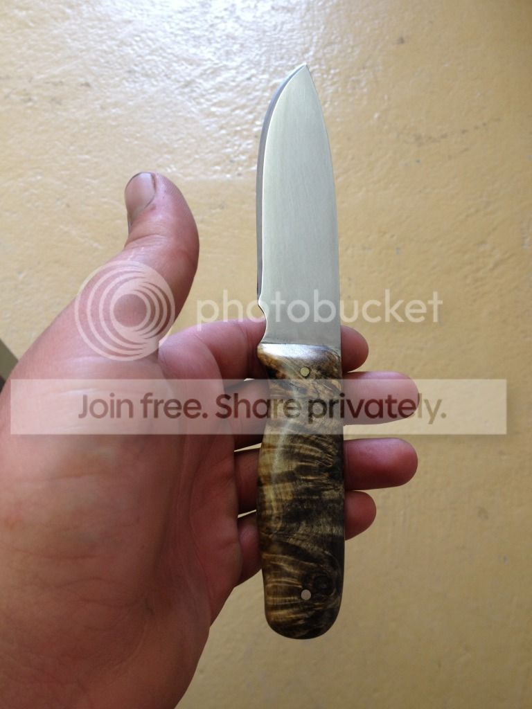

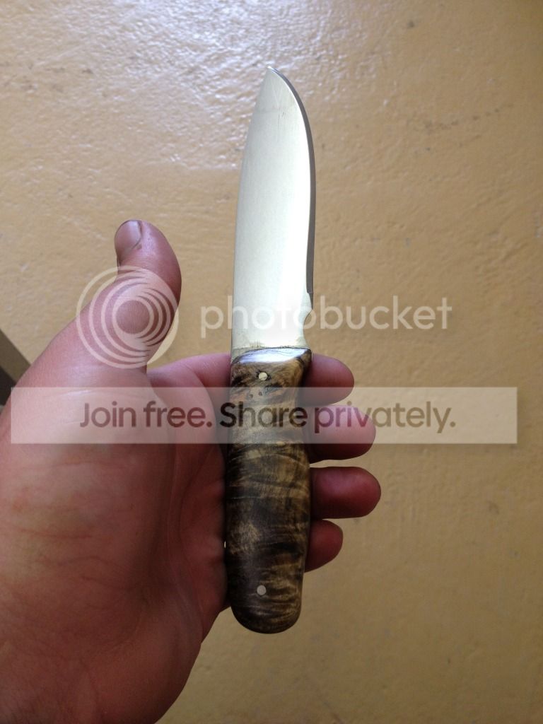

Ok I just made my first knife
Blade: steel from a diamond tip concrete saw blade
Handle: California buckeye, danish oil and semigloss clear spray laquer, silver nickel pins and gorilla glue 5 min epoxy
I got this thing finished Friday. Saturday night went camping used it to cut steak, peppers, onions and bait works excellent.... Woke up Sunday morning the blade had rainbow colored stains and rust all over the blade... I wiped off everything from the blade before bed Saturday night... Was I supposed to put a coating over the blade? I was able to wets and everything off of it but not thrilled about what happened.
Some steels do that. You should wipe with oil of some kind. If it's a simple carbon steel it will get a patina from meat and acids in food pretty easy. Any idea what steel it is?
Thanks for the response. No idea what kind of steel it is.... With a good cleaning and oiling every night after use would you think I could keep the stains away? Or am I going to have them just because it's carbon steel?
I don't think you can stop it completely but you can slow the process by wiping with mineral oil after cleaning and drying. Do you have pics?
Who made the bit it came from? May be able to track down what material it is.
Ok that's a good idea about the mineral oil.... Yes I have pics of the blade after it stained and after wetsanding.... I just need a little while to figure out how to get them from my phone to here lol

pic didnt work for me but I will tell you this. the blade is gonna stain... might as well make it stain in a controlled way if you dont like the way its gonna do it on its own. forced patinas can be pretty cool looking.
