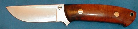

Well, he certainly earned his rep. He made me a wonderful gift of the only convex ground blade he had ever made up to that point in time several years ago. He was adamantly opposed to convex vs "V" grinds, but ended up impressing himself. ☺️

On another, (outdoor related), forum we tried to convince him of the utility of a convex grind for bushcraft and other usage, but not remembering specifically now, I think it's more that he cut his teeth on the "V" grind and being able to precisely measure angles etc...but being the guy he is, he agreed to produce a convex blade and test it himself as well as send it to some of us.
After he gifted it to me, I had one member of that forum put a handle on it, and another make a leather sheath.
View attachment 2935425View attachment 2935426
Great looking knife.
Looks very useful, and his style carries over strong.
I never had the pleasure of his work, but I admire it alot!
Someday I'd like (I can't remember the model) something like basic buffalo series?
Rounded, full grip handle, metal guard. Simple yet almost elegant.
