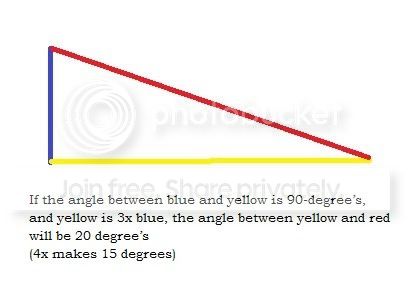

Thanks for all the great responses, guys. I am tempted to get a clamp system like Lansky, but I'm hardheaded, so first I want to try to get good at sharpening with a stone. It just seems like something I should be able to do.
My blades are all 1084 and 1095. I use a Craftsman 2x42. I'm not sure what grit the whetstone is, but it has a coarse side and a fine side. I hold the blade at about 20 degrees.
I free hand sharpen with diafolds. I clamp the knife and move the sharpener.
I made some triangular blocks I use to align the sharpener.
Here's a quick way wo find 20 degrees and 15 degrees:
