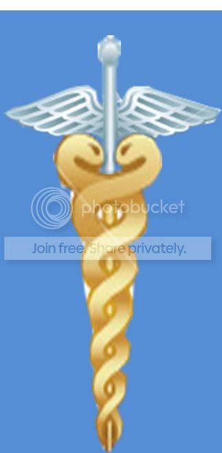

So I'm starting to get close to finishing the leaf knife, and naturally my mind starts to wander into the future... the bleak barren future in which no knife projects are on my table. As it happens I had a reason to go check out my medical benefits, and came across something that started singing to me, like the magical blade in some Bugs Bunny cartoon.
A caduceus...
So I went on wiki and found an image of a caduceus, then modified it a bit... this is what I came up with:
Am I the only one who thinks like this? Obviously, a blade made in this pattern would serve no useful purpose in this world, or any other. But for some reason I feel compelled to attempt it. Worse still, I know my skills are not up to it... but that's kind of the point... I might actually learn something if I try.
Sigh... I guess I'm doomed now. The idea won't leave my head.

It sounds like it's time for you to make an art knife. I get the same thought from time to time after making a bunch of using knives. The urge rises to get creative and make something that reflects that urge.
why not extend it, and shrink the "wingspan" some, and make it an art sword, instead of a knife.
or use the staff and wings part to make the sword, and the coiling snakes as a scabbard of sorts

If anyone is interested, I started work on the Caduceus blade yesterday. This one will take some time. It will be smaller than I originally envisioned... blade length will be only 4 inches, and overall length about double that when done. Of course, I'll be using damascus (1084/15N20)... actually, the other half of the billet that I used for the leaf knife.
As usual, I have some crazy ideas that may or may not work out and some problems to think through before I begin cutting.
- Greg

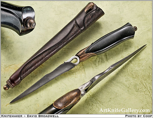

Years ago I was eating breakfast at a cafe in Eugene Ore. Saw a photo of Lauren Bacall studied her upper lib and found a design that came to be in a future bowie.
Studying the design features of the geometry of the hull of a racing sale boat I found encouragement for a fighter design and it influenced all the Bowie I have made since.
Knife design is everywhere when we have gained enough knowledge to see.
