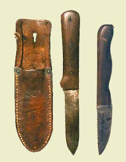

Here is the original kephart and sheath that the man himself, Horace Kephart carried.
That sheath is so beat up - I can barely tell what it is.
Can anyone point me to a more modern - or better example of what this sheath looked like when it was new?

I have been looking around for some pictures. These knives above appear to be from the Horace Kephart Museum. Colclesser Brothers supposedly made his knife - but I can find - and others have said - that no one has seen an actual production knife of this design. There are pictures of THIS knife being carried by Horace Kephart and it appears he wore it until his death.

Given this photo - my best guess (and I am likely off base) is that the belt slots were simply cut into the back of the sheath. The hole in the middle of the back was from a retaining strap that tore out.
What do you think?
TF
I agree on the torn out retainer strap, it happens first with those old designs , most of them were either riveted or a stitch or two sewn on. Neither is a good idea.
Though, I do want to see two layers of leather showing on the front. but I have seen the slotted sheaths in the past so it makes sense. I will download that clear pic and make it big for these sorry eyes that I got. Next time I sit in the LONG line for good eyes!!! :p
FYI - the rivets and burrs are copper in size 14 which are still available from some suppliers...and the leather appears to be 5/6oz or at most 6/7 oz typical of that period sheaths for this size knife.....
I bet its the patina, but those rivets and burrs look like brass to me. I have some just that size and material I got for civil war re-creation.
Tal, I will be glad to draw up a pattern for the sheath, but I will need a very accurate outline tracing of the entire knife you are going to use.
I will be departing for the Blade show in Atlanta tomorrow and will not return until Monday next. If you will send me the tracing I will do the pattern when I get back. I agree with the opinions so far. The belt slots are just cut into the back and the hole in the center of the back was probably the attachment point for the around the handle retention strap. Finding hardware and snaps to match the period will be a chore and may not even be possible.

I personally think the slot is a button hole for mounting the sheath to a suspender button. As someone else agreed and pointed out in another thread, belts were not as popular as suspenders at that time.
With continued thought, I guess the button hole idea is as good as the torn retention strap theory. Who knows?.....not me. If part of the handle goes into the body of the sheath, then further retention may not have seemed necessary. Plus the fact the people who really use and depend on their knives generally keep pretty good track of them and know where they are all the time...........and probably were not given to wild gymnastics that might cause the knife to depart the sheath unexpectedly. A photo of the knife in the sheath would address many of these questions.
Paul
I hear you Paul - it could be that the slits cut were cut to be used at the button holes of the suspenders - and as belt loops.

I think Paul is on to something with the knife sitting deeper in the sheath, there appears to be a molded area about an inch deep. :)
I love the button hole idea! The sheath would flop a little when walking, but its a nifty idea.
I hope you get those pics TF! That would be fantastic! Be sure to ask about those rivets as well, I'm very curious.
Dwayne - both types, copper and brass, were used in period, but brass rivets were used almost exclusively by the military. As for the patina - I've aged hundreds if not thousands of both types and when doing repair work on old stuff so many "naturally" aged". Generally you can't tell the difference between the two just by ere, especially since on old period stuff it is even harder to tell since the brass at that time was commonly the simple and traditional alloy of 10-15% zinc and the rest copper. Modern brass mixes are generally different in the ratios and often have other alloys included..
An yep looking at it closer I tend to agree with Rick re: the suspender button carry and that the front of the sheath was originally full length
Not questioning you at all my friend, just very curious, I'm flawed that way. ;)
Copper tends to age darker than brass and that is what caught my eye, I thought it interesting that he might have used brass over the more readily available copper. Even today its much easier to find copper rivets than brass. Took me several months to find what I have, with the domed head rather than the easier to find flat head.
