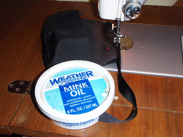

Edging tape is folded and sewn on. I’ve found an empty mink oil tub, with a slot cut in the side
works nicely as an edging dispenser of sorts:

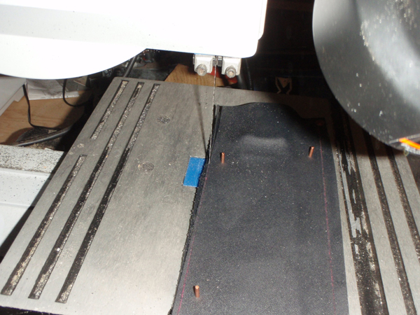

Ok; so here's the cutting, the band saw is the ONLY way to go - I say this because of
all the cutting I've done by hand :o ...
Four rivets index the two sides, they're what will hold the pouch on...
All cut, and finished with a bench grinder, and sandpaper. The holster to which the sheath

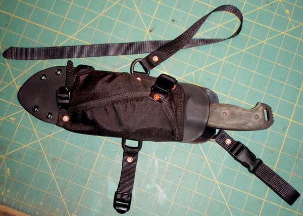

Here's the final assembled sheath.

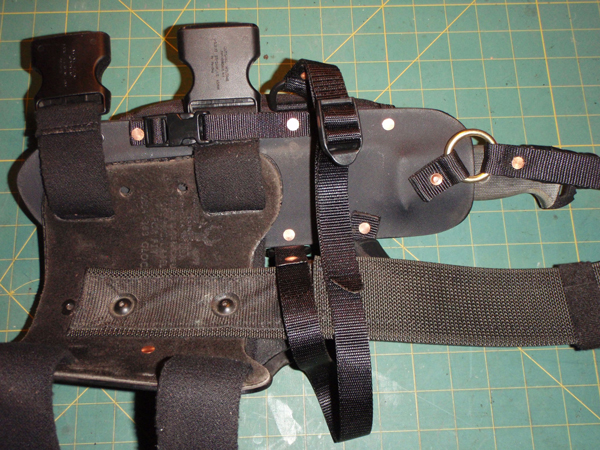

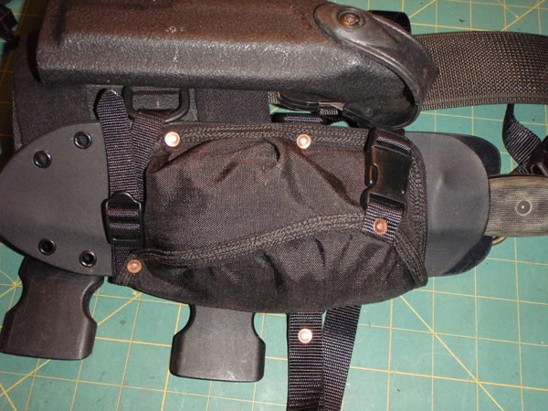

... and attached to the holster, the 5/8" strap with the ladder-buckle is used to loop through the "D" ring.
The back view show the 5/8" strap and side-release buckle that hold one of the leg straps.
The leg strap on the sheath was located so that it is above the holster.

Nice tutorial... And job. I think I would have skipped the fastex buckle on the upper leg strap though. Just a length of webbing would have sufficed and been lower profile.
I believe the idea behind the buckle is convenient, no need to un-buckle your belt to put on the rig, just pull the buckle thru and attach! :thumbup:
Yup; more convenient, and it also provides a tighter "fit."
Having a simple (and I do like simple!) loop large enough to accomodate the buckle would
have allowed considerable floppage...!!
