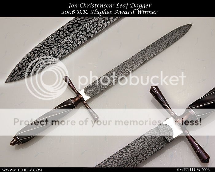

Jon Christensen is a abs master smith........amazing!
Any thoughts?
I believe this is Jon's Mastersmith judged dagger. Only Jon can do the "leaf damascus" like this! Gorgeous.
Jon's done some incredible things with his damascus. The leaves have always been a favorite of mine. He's since done feathered leaves, a full tree, and even feathered bamboo leaves to match a handle of ivory carved to look like a bamboo stalk.
He's always pushing the envelope and coming up with ways to keep upping his damascus game.
Jon's mastery and control of the pattern is just off the charts ! :thumbup:
Visualizing this in my mind's eye, in reality it must be incredible. ^
Thanks for sharing 9blades !
..and thanks for the move Esav.
Doug
Doug here is Coop's pic of the knife. The picture is a good one but you can't see the bamboo leaves all that well but you get the idea. It really does look just like bamboo leaves. :)
John,
Thank you very much for the image, I was gonna' ask if anyone had any pics and didn't.
..and then you post a Coop shot ! :cool:
I can see the bamboo leaves nicely, thanks again ! :thumbup:
Doug

The initial leaf is a straight laminate pattern (straight lines like pages in a book) of approx. 25 layers that is welded and drawn out to about 1/2" square. It is then cut in length diagonally and one half flipped end for end. This makes the lines flare out in a V pattern.
I then put a piece of 15n20 in the center of the V to show the leaf main vein and leaf stem. This is then welded together and forged enough to form the leaf shape I want.
This "leaf bar" is then cut into 3" pieces which are put into a can and powdered steel is poured around the leaves to isolate them.
This can of leaves is welded and drawn out. This new bar is then then 4 wayed (4 square bars stacked to form a new square cross section which is then welded and drawn out) to reduce the pattern until I have the leaf size I want.
Hopefully this explains it somewhat. Feels free to ask any questions you may have.
