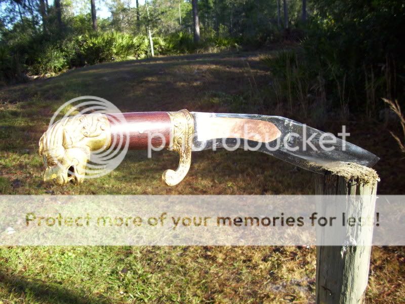

They do exist! Email Ms Yangdu; she might have one in stock. Corporal Punishment has one he's rather fond of, and I have a hybridized 20" CAK-ish variant.
LOL, actually, I have a few 20 inchers.
Let's not forget KukZilla, my 25" CAK:
Several AKs...
That beast is almost as big as the AK (rifle). Wow. :eek:
The Cpl sure likes big blades ... so do I but I defer to him as he actually uses his, whereas I just admire and polish mine. :o
If your lucky he will post photo's of his Giant Chitlangi Bowie and Bhairab.;)
Well, Im trying to aquire a CAK thats at least 20". Unfortunatly, Ms Yangdu doesnt have one in stock. Sigh....
