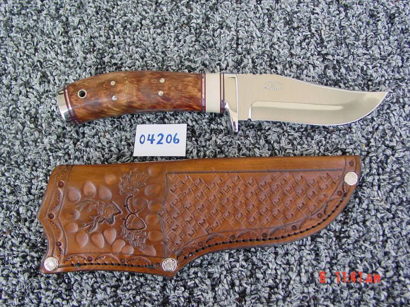

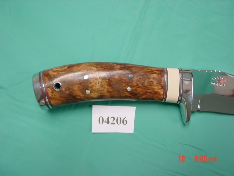

This knife use to be the Amboyna Burl guthook and I had many nice comments on it with the exception of not liking the guthook. Well I took the hook off, don't worry it did not hurt the blade temper to make this mod. It shortened the blade slightly (see specs below). This knife feels very good in hand. Let me know what you think of the change.
Thanks and God Bless!
Jim
04206
1/8” ATS-34
Hollow groung, Heat treated and double tempered to Rockwell 60C
9 5/8” OA
4 1/8” Blade (used to be 4 1/2")
303 STAINLESS GUARD
303 STAINLESS / RED / IVORY MICARTA SPACERS
WSSI STABILIZED AMBOYNA BURL HANDLE
CERTIFICATE OF ORIGIN
7 OZ. CUSTOM TOOLED COWHIDE SHEATH (VERTICAL)
