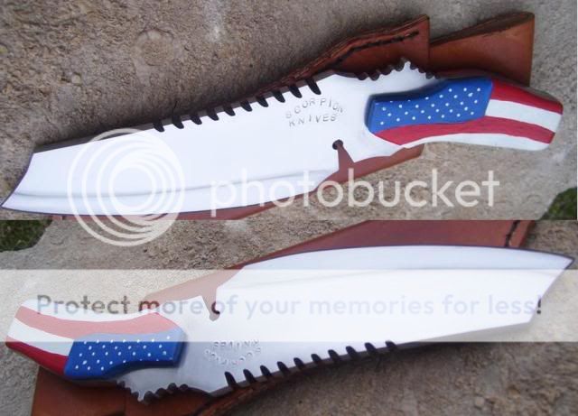

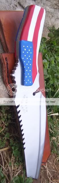

Thought I’d get patriotic with this one. This video shows the making of the “American Chopper” Knife in our shop along with a few patriotic & military pictures.

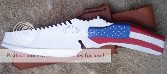

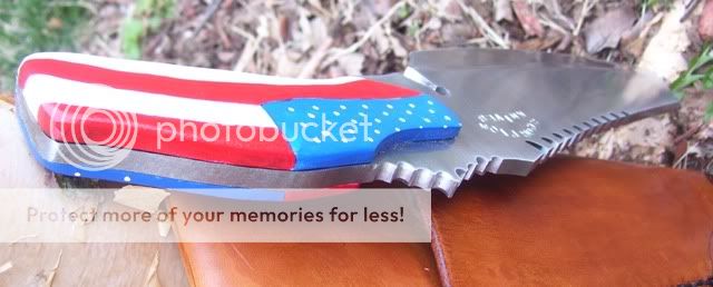

I put hidden pins in the scales this time, like some of you suggested. Painting the flag was a bit time consuming because I had to use several coats, but I was pretty happy with it once it was done.
Pictures of the finished knife.

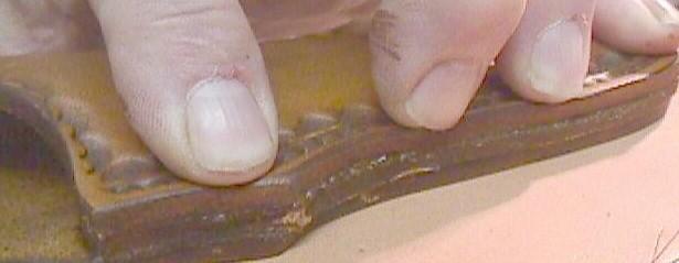

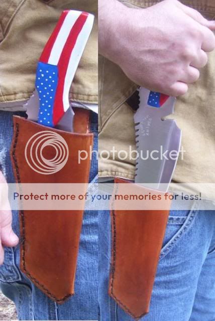

The sharp edge points toward the fold in the sheath and not the welt?
I don't do it that way, because I don't want to cut the stitching. That's my preference. I can't even imagine that you would want to do it the other way? Nothing like, over time, not realizing you've been cutting your stitching, then one day you look down... oh my .... my knifes gone.
you should use a welt, then your stitching won't be cut.
As to the knife, it has some issues but I don't know if you are looking for criticism.
Chris doesn't use a welt in his sheaths.
Chris, a welt is a layer of leather at the seam that you stitch through and prevents (usually) the edge cutting through the stitching.
Thanks Will. Had no idea.

Since it's supposed to be an art knife of sorts, I guess it doesn't matter much, but the knife looks kind of hard to hold and use. I mentioned this on your first knife and haven't brought it up since, but I really think you should consider carrying your grinds up another 1/4" at least, if not 1" or even a full grind, this will make many of them more handy.
I was wondering about steel type(s), who does the heat treat, and approximate Rockwell hardness.
By handy of course you mean able to cut efficiently. I agree.
Angle grinders are not suited for grinding bevels.
Edit: I watched some of the other videos, and I see you have belt sanders. I guess I just don't get the choice of blade geometry.
A few points, in no particular order... And I liked that last one you posted, so I'm not trying to be rude, just helpful. :thumbup:
-Pins.
-Gaps on scales. Could be fixed by pinning, and clamping firmly (but not too firmly so as to squeeze epoxy out), after thoroughly flattening the bottom side of scales with sandpaper laid on a sheet of glass or something.
-Also, ergonomically, I like a handle to be more round and less flat. All of my firsts had flat, wide handles, that were not comfortable to use for any length of time.
-Also, if you don't have a belt grinder suited for knife making, getting a good flat file would be a cheap solution in the mean time to crisp-up those bevels and maybe bring them up higher.
That's about it. Good luck :)

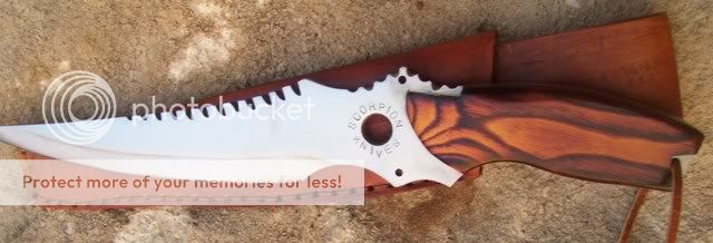

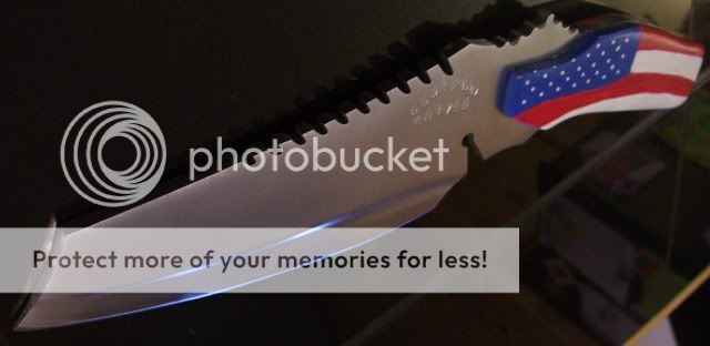

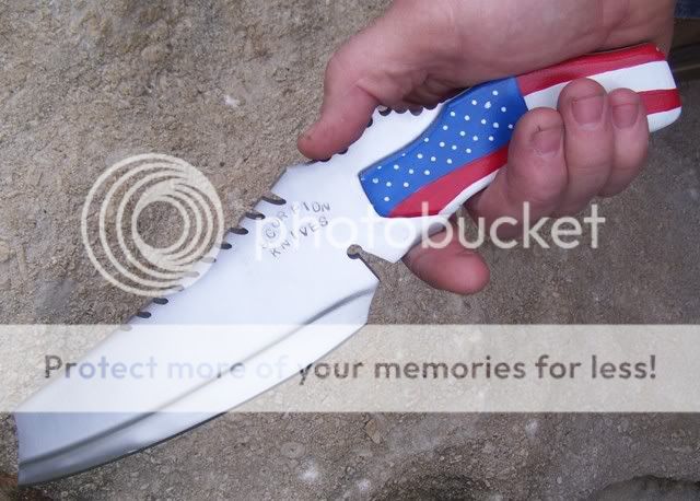

As far as my bevels, I seem to be getting along just fine with what I have. You can put a very good edge on my knives. Not all of my knives have that kind of bevel. Just my big square choppers that have sold on this forum. Below is a picture of the bevel on my last knife as well, which a lot of people loved.

I understand and respect your creative license, I didn't originally intend to get anyone on the defensive, that's actually the main reason I haven't posted on any of your other knives. That being said, since you post many knives here and since you're selling them, I think you should be open to what folks are saying. Everyone here is trying to be constructive and polite.
Gil Hibben is an incredible maker, I agree, he gets very wild with his knives just like you're going for. It may be hard for you to see, but I do think there is quite a difference in his handle contour and yours.
I've looked over all of the knives you've posted here and I've looked at your site, no one has to agree with me, but I think the grinds should be higher and crisper. Your knives will feel better, cut better, and (in my opinion) look better. If your choppers are more like splitters then they don't need a higher grind, if you're blades are interpretations of knives, then they don't even have to cut. If you don't want to improve, please disregard my advice.
For what it's worth, my knife grinds were pretty similar when I started and I thought they were fine too.
Chris, generally when someone posts a knife here people are going to critique it. It IS the maker's forum and we're all here to improve the craft, well most of us, I know I suck at knifemaking so I'm always looking to improve.
Gil Hibben also made very "normal" knives in addition to the blades that are "classic Hibben".
I'm not going to address the various posts, I hope you didn't take mine as an insult. I was answering someone's question because I knew you weren't on and thought I'd add some information regarding a welt. If I did come across as insulting to you shoot me a pm and we'll talk this out in private.
If you think your knives are fine then don't bother listening to people. If you want to improve then put your knives up for critique. If you really want to hear what collectors think about your knives put them up in the "Custom and Handmade" forum. People in here have been very mild and polite compared to what those guys will say to you if they bother to post at all.
