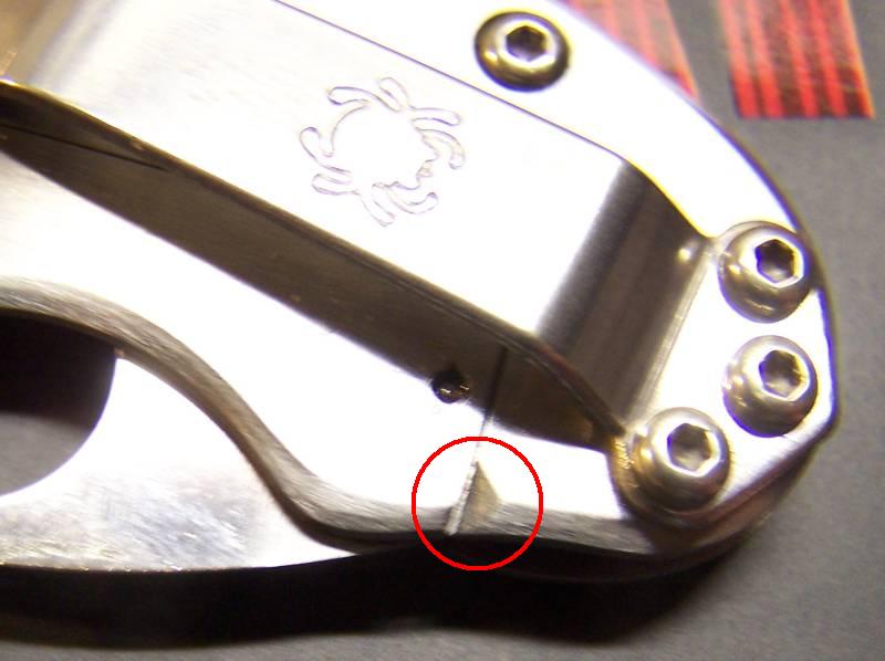

As has been said photos would be very valuable because, for example, if the notch/ding looks like the one inside the circle in the photo below, it's normal.
Oh, I was just going to say, I don't have photos because I only have a webcam, and it wasn't picking it up correctly. That is exactly what the notch/ding looks like. I thought it was a flaw because it was so roughly finished and scratchy. Can someone explain to me why that is normal?
The relief bevel is probably there because otherwise there would be a sharp pointy spot there when the knife is open and the front of the lockbar is no longer level with the frame. As for the slight roughness, if it's any consolation, that same spot on my Chris Reeve Mnandi is not a place I'd want to run my tongue over either. I use it as an example because CRK products are generally regarded as extremely well finished. Not an easy spot to get to on the Cricket as the gap between the rigid portion of the frame and the lockface area of the lockbar is very narrow. If it's really bugging you, you could try rubbing that spot with the striker strip from a book of matches.

Buy some Flitz and use a Q-tip or something to smooth out any rough.

I cannot speak for the dealer, others here know more about that, but I can say that the "chip" is an intended grind, and not a chip.
