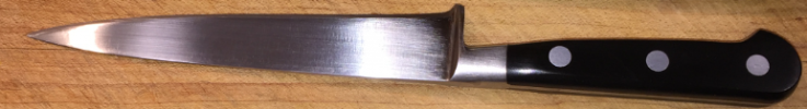

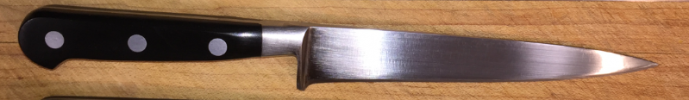

This is a vintage 1980 Sabatier "carbon" 5 1/2" chefs knife. When new, the heel of the edge ran right up to the lower end of the bolster. Over the years, it has been sharpened many, many times, and the edge has withdrawn considerably upward (making that bolster something that is just in the way, and also increasing the BTE thickness). I try to keep the edge angle at 15 degrees per side and limit material loss .... but that has its limit, and the years have taken their toll on the BTE thickness. I do not recall the exact measurement - but I can tell just by feel that the BTE measurement is .... Not Good. :-) . With the softer steel, I can somewhat reasonably keep this knife going (it is my go-to knife for taking pits out of avocados :-) ). I think ANY knife, however good the initial edge geometry, would suffer this kind of degredation over the years (20 - 30 - 40 of those years). It is from that perspective that I still sometimes think that the softer steels are more "friendly" when it comes to making major "renovations" in the blade geometry over the years. Also take for example that original chinese peasants cleaver: I completely re-profiled and convexed the edge and got quite a good working edge on it - and it took me maybe 20 minutes.......

You should shape that bolster down so you can acutually make contact on the cutting board.
That is non sequitur. I was talking about the BTE thickness. This particular knife is too small for chopping - i use it for draw slicing - so the protrusion of the bolster, by itself, is a non issue for me.
