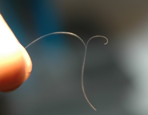

Theonew, when you say "whittling hair" do you mean that you're holding the knife off your skin and cutting part of the hair off, or a normal shaving motion? New guy, unsure of the terminology...
Parker
Parker
I can understand the confusion, I'm not sure it's an industry standard term, lol :D I'm using it to mean that I hold a hair by the end in one hand and then cleave a sliver of it off with the knife's edge. Here's a pic:
