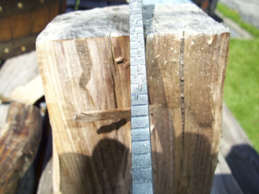

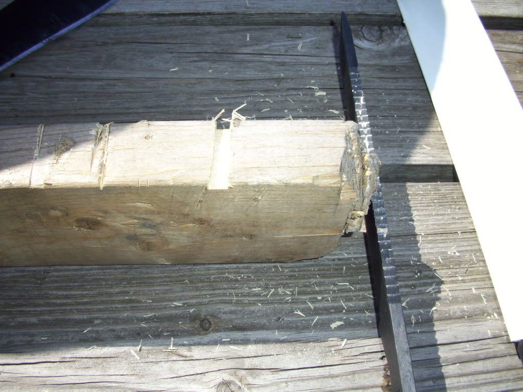

SP-8. Yup, I think it is an often overlooked but awesome tool. AND, with a few simple mods, that are fun to do, you can make it better. (the price point of OKC products is such, that you can do some mods & IF you mess up, you are not out hundreds of dollars).
I sharpened it to a razors edge, then used my Dremel Tool, with a thin cut-off disc, and sharpened the saw back teeth tips & then cut/notched irregular grooves into the teeth. It now cuts WAY better & does not plug up as much or as quickly. Although considered ugly by many, I think it is a thing of beauty. IMHO, when something is 100% functional & built better than it has to be, by default, it is naturally a thing of beauty. LOL :)
