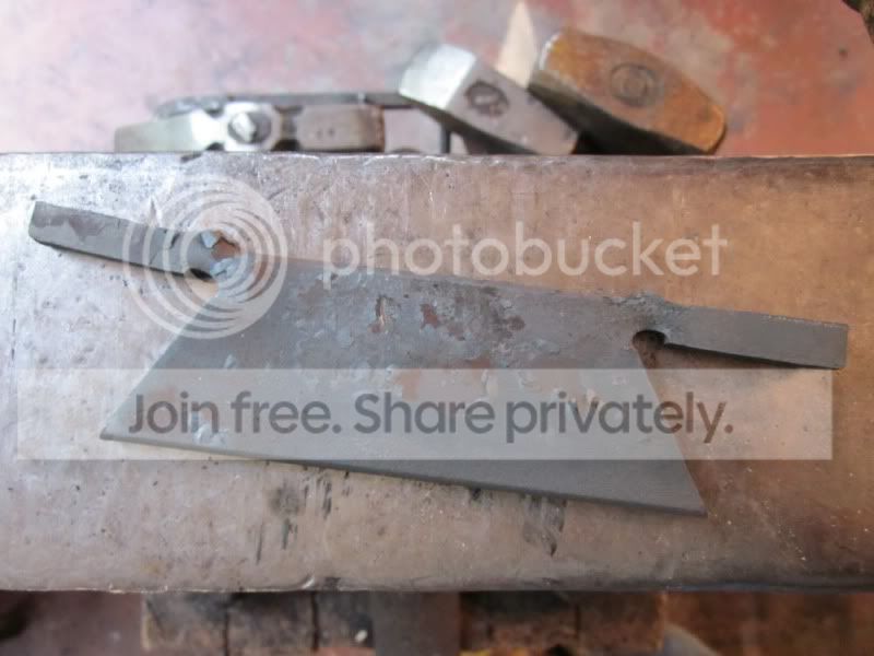

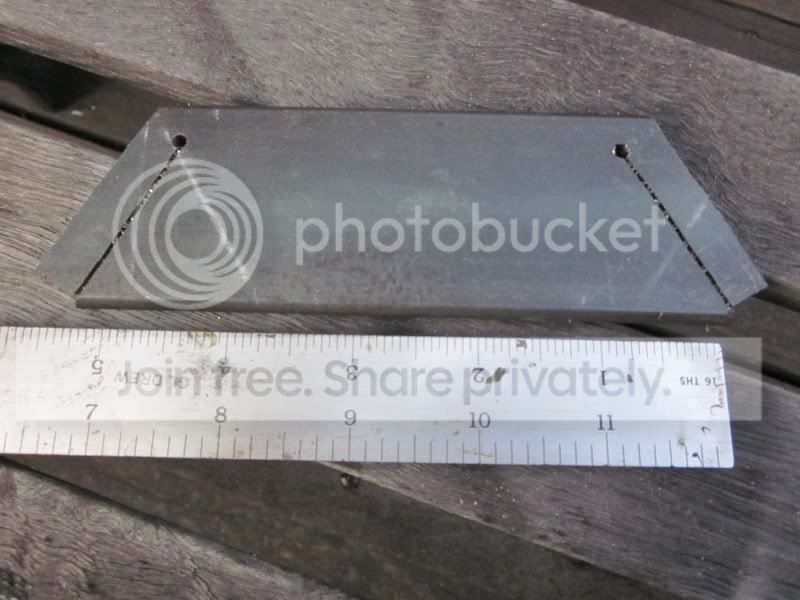

I laid out a piece of 1/4 x 1 1/2 inch 5160 and cut along the ends for the handle posts. (Yeah, I know, a traditional blacksmith would have hot cut the steel and not used a saw.)

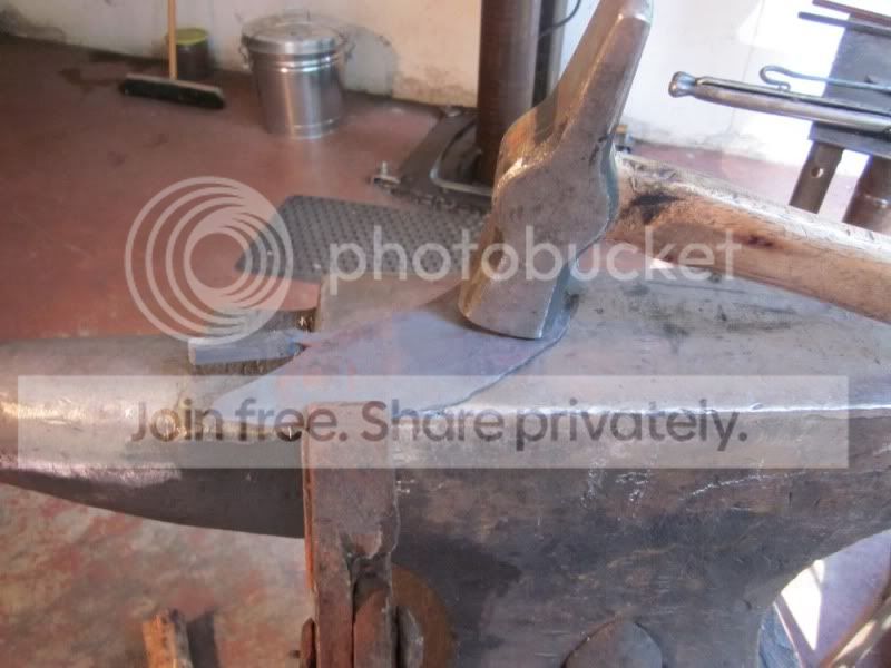

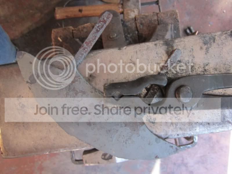

At the forge I moved the legs out of the way to start forming the blade.

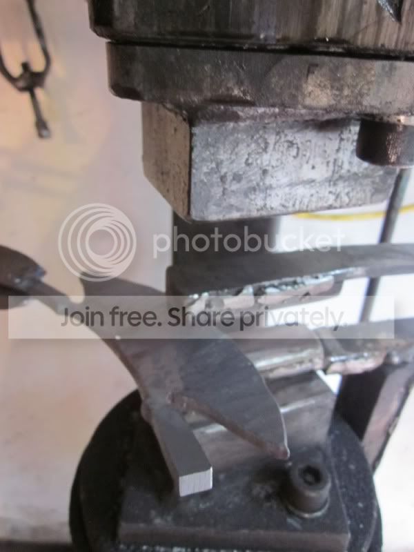

Using a half round spring fuller I started moving the steel toward the ends of the blade as I tapered the steel. This forces a nice curve into the blade which I need for the finished knife. This happens when I forge a straight knife too and I have to fight the steel back into position but here this works to my advantage.
Here I am using the "heel:" of my hammer to move more steel toward the edge which also increasing the curve.

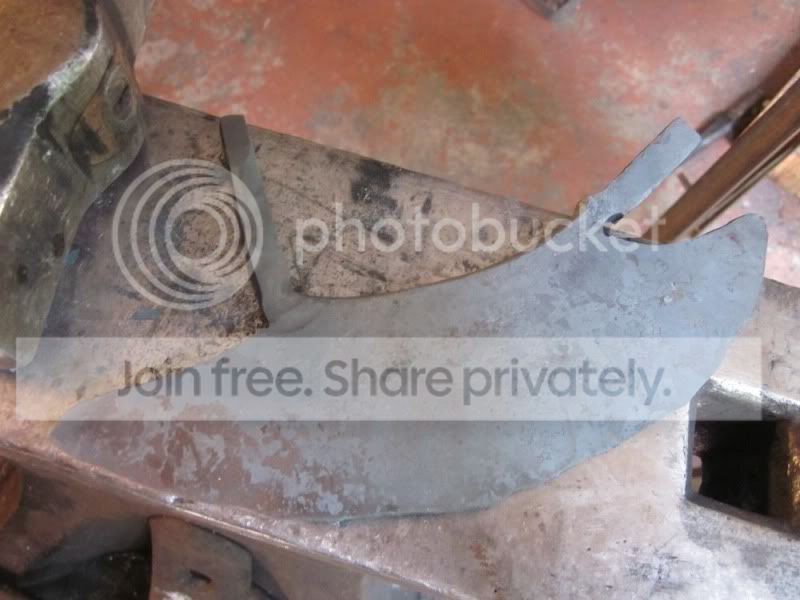

Forging the legs and moving them up into position

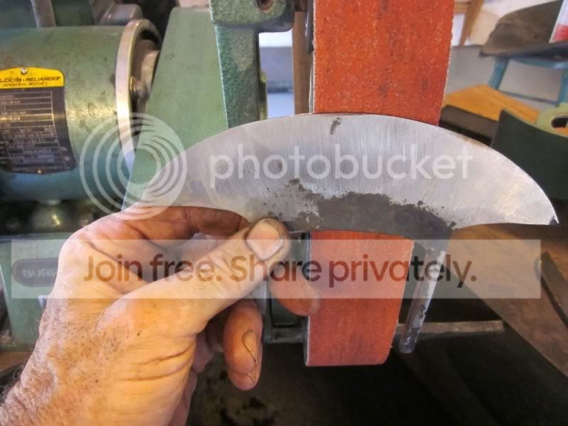

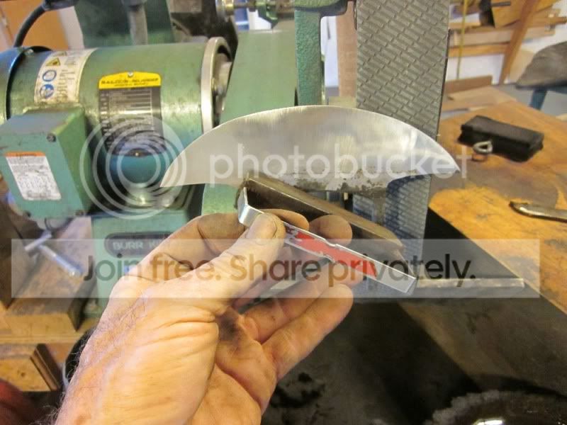

Using a 50 grit belt on the grinder I profiled the knife and did a rough grind on the blade.

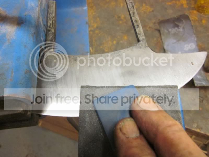

Machine sand to 220 grit. The magnet really helps out here with no handle to hang on to.
Always some hand handing involved.

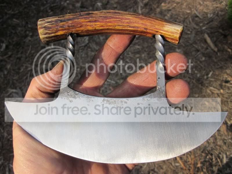

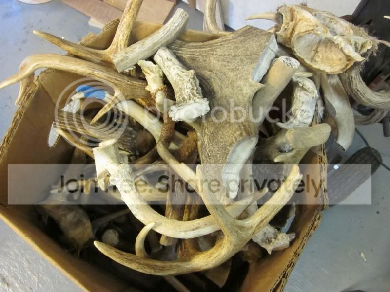

A couple of twists to the legs and the right antler will complete this knife. I still need to glue up the handle and maybe put a mustard patina on the blade.

OK, braved the heat this afternoon and finished it up ready to skin a seal, slice up a salmon or cut a pizza. Works well on veggies and fresh herbs too. I think the mustard patina and the forge marks give it an antique look.
Stabman and 1234567890; The antler is held in with a good two part epoxy--should have mentioned that myself.
Kentucky; Yes that is a tire hammer built by Clay Spencer. He is a real proponent of fullers and gave me a lot of information on them when I picked up the hammer. Some of the fullers I have made work very well, some not so much.
