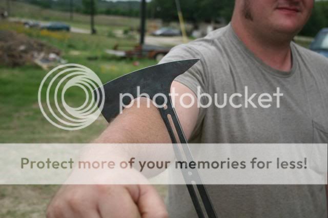

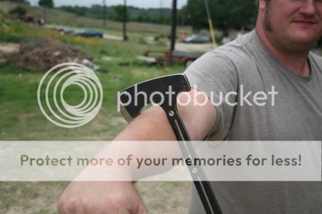

Retention in the hand, a handle that won't break, spike that won't catch and will easily withdraw from a wound to allow for quick follow-up shots, and hooking ability are all things I considered on mine. The ability to hook a limb and re-direct it, or hook a neck or belly and rip are one of the areas of advantage that a 'hawk has over a knife in close quarters.
In fact, making sure the beard was open enough to hook a limb easily was one of the adjustments I made while prototyping.
Note the sharpened beard in the photo. If you need to hook, adding another wound is part of the stroke. The comment about the spike being easily extracted also has significance, some utility hawks aren't sharpened or meant for it - they add ridges for grip when levering.

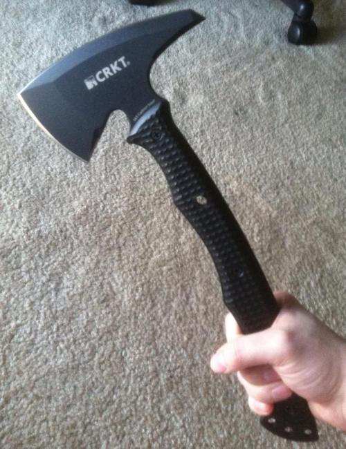

One of the many reasons I'm such an advocate of the VTAC is due to its hooking applications made possible by by the beards unique design. The blade has no way of hanging up in tough material like bone, cartilage or metal and affords the user enough head length to control whatever limb or body part they choose and still be able to release while "slicing out" at will.
