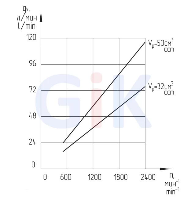

Little update and questions. I took apart oil pump and measured dimensions - shafts are 1inch, gear teeth is 32mm wide (1,26in) and gear diameter is 55mm (2,16in). Now I can compare to newer versions for who I can find technical specs. Or can I calculate flow rate from my measured dimensions? I am still learning all that stuff. Rpm would be variable in calculations, but what is displacement volume? How can I know that if I don't have manufacturers data? Skidder datasheets says pump is НШ-60В, where 60 is cubic cm working volume. That can't be displacement volume, right?
Closest what I found from what is still being made is that in picture:
They don't make НШ-60 anymore (if that is what I have), models now are НШ-50 and НШ-71. If I use manufacturers data and my extrapolation for 60, then I get 35gpm at 2400rpm on pump shaft. Does that sound realistic?

Well, pump shaft is one inch and it weights little over 6kg, if we compare to yaegoo 11gpm, then yaegoo has 1/2 shaft and weights 2,82kg. With that in mind, my calculations (35gpm @2400rpm) doesn't sound too unrealistic. Where do I get 2400rpm? That's picture from manufacturer. These numbers are for НШ-32 and НШ-50. I believe I have НШ-60, version 50 is lighter about a kilo, so I am optimistic.
I agree about oil tank. I will build first as is, and then add bigger tank and/or chiller coil, if needed.
It sounds like a big pump. From your numbers, probably 27-32GPM.
