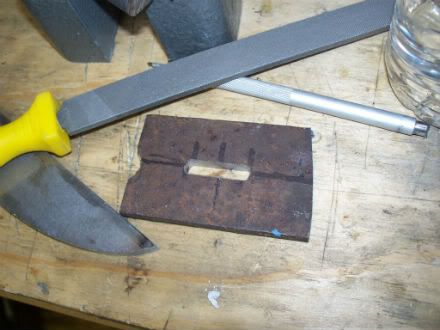

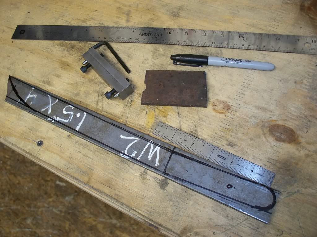

W2 Steel - super clean high carbon tool steel with Vanadium, W2 is top notch material and the choice for many high end customs. W2 is water hardening so I will use a brine solution to quench the steel.
Wrought Iron - recovered from an 1880's Lake Superior lake side grain elevator!
Real wrought iron is rare material, no longer produced. It was used long ago when a strong and somewhat corrosion resistant material was needed. It has a fibrous structure that adds strength and was used for ironclad battle ships, anchor chains and even the Eiffel Tower.
I'm hoping to make a semi-traditional Japanese Tanto with a wrought iron guard! I'm likely going to try for a nice hamon and will be etching the wrought iron guard to show the beautiful grain structure. :cool:

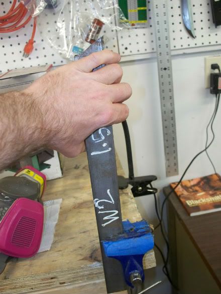

Straightening the W2 - it comes pretty straight but I had to take a tiny bend out of it, always a big challenge to get right. Luckily this W2 is extremely soft so I could use my tiny vise.

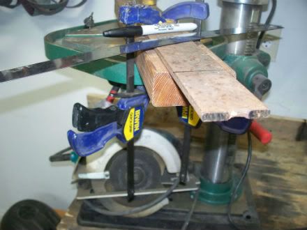

Materials

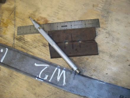

After more scribing, drilling and lots of rough filing

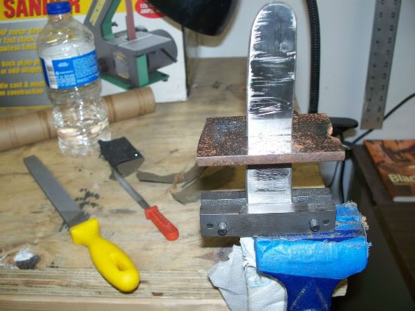

So far this has been a great lesson, I tried something completely new to me and it has worked out well. I spent a ton of time on the guard and managed to get a nearly seamless fit.... unfortunately yesterday at the end of a long day I decided to grind the bevel and screwed that up! I have only done that twice in about a year, lol it figures it would be on this. I still feel it was a big victory, my first guard and it looked great. I will order some W2 next time I talk to Aldo and finish it up. Next time I will keep the spine straight and leave the curve up to the quench Gods. As you know with water you can get lots of upward curve! :D
Sooo, is it so screwed up that we are gonna see it made into W2 kiridashi's?
Yeah fitting guards is time consuming. But its even more frustrating when you do it before HT. The blade changes shape so much in HT that the guard will never fit right after. I fit them after HT now. A little tip, you can pein around the edge of the opening to help seal up any gaps. Then grind the face flat. Now try it on a guard the size of your US M3, I think I made three complete guards for that knife before I finally got it right!
Well, keep at it! Perfect Practice makes permanantly Perfect!
-Xander
No I made it tight for a press fit, it was about 3/8" from the guard fit wise. I press fit it anyways just to see. I know post HT is would be different but wrought iron is soft enough to do that. I was planning on a seppa and possibly fuchi for it too. Good to point out though, if I did not know that it would have been a waste on the next one too!
I tapered the fit too as well as keeping the edges where the guard fit fully rounded, I think I will stick to that method for what I want to do. It looked cool!!!
