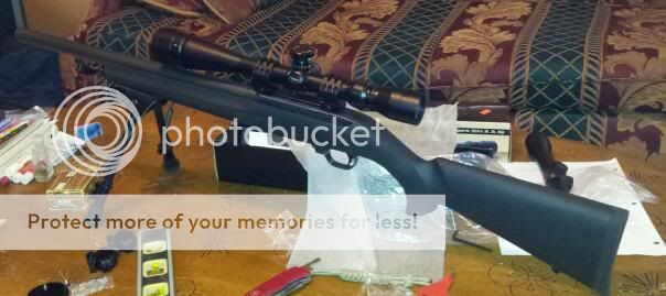

I just pulled a 3 day drunk and built a rifle while I was in the sauce too. After seeing how it turned out, I might have to do all my builds tanked. :D

Good looking rifle. What scope did you go with?
Nice rifle. What are the specs?
Ruger 10/22 reciever, Green Mountain barrel 18" .920, Hogue Stock, BSA Sweet 22 6-18x40AO scope, Weaver Tac Rings, Leupold base, Harris bipod (made in Barlow, no shit), and a match trigger that I did myself. Breaks at 3lbs crisp, no overtravel.

Mmmm..sweetness. Nylon bolt buffer? It goes from clak to just a solid thump.
Haven't changed anything in the guts yet. How well does it wear?
I was going to get a Timney trigger group for it, but the damn things are hard to find. Saw one at the gun show, for $210. Whoever paid that much for it, was a impulse shopping dude, for sure.
Moose
Cut off a 1/4 inch nylon bolt from Home Depot, tap out the steel one and tap in the nylon. You can rotate it or replace it after a few thousand rounds. Two bucks. Mine's been in three years and had a few bricks through it.
