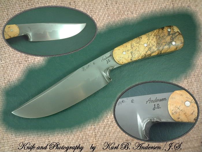

How can a knife maker spend the weekend around Joe Keeslar and then NOT go home and make some of these??
It's impossible.
For those on this forum not familiar with the process - and I'm certain that is VERY few! - the term "Brut de forge" may be translated as rough and unfinished or gross forgeing.
Regardless, the knife may appear to be somewhat unfinished, and this is intentional.
It has all of the attributes granted to more refined knives, in that the steel is of high quality, it is offered the best heat treating that I can give it, and it has its own unique and distinct qualities.
The blade was forged down from heavy 1095 steel stock and differentially hardened using clay backing, which also results in the hamon activity seem in the inset photo.
The handle scales are stabilized cross-grain spalted maple.
A HEAVY knife!
Quite a handful.
(More of these to come in the future.)

I really like it. I think I would like it even more with some extra "forge texture".
Roger
Roger
That's easy to get when you hollow grind, I chose to flat grind this one.
It's 1095 and I didn't want to waste the hamon to forge scale.
Just a choice I made.
(And you thought I didn't think about this.)

I'd like to see more 'brut'. It's just too nicely finished.
Echoes my sentiments, also.
Paul
You guys are sure picking on me for such a simple knife.
To have scales up further that area needs to be FLAT. Can't just lay that on something to get it flat with the flared out choil.
I didn't want to cover up my stamp.
