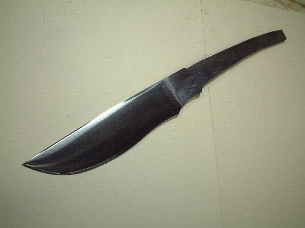

Anyway, here is the direction it's headed.

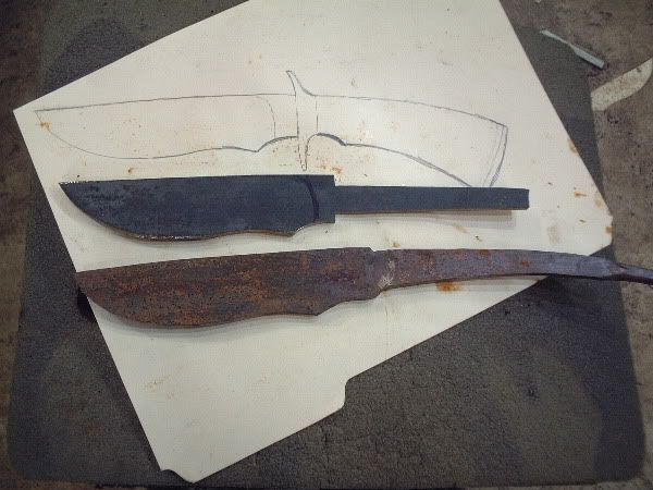

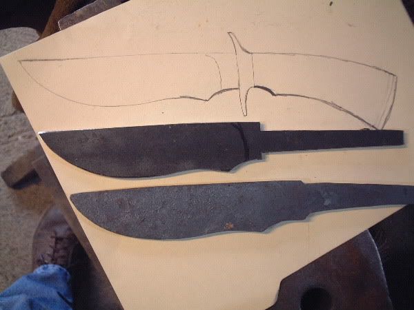

I like to cut out a profile of the knife I want before I forge and make some drawings. Then, if I like what I see, I can forge my blades to shape.

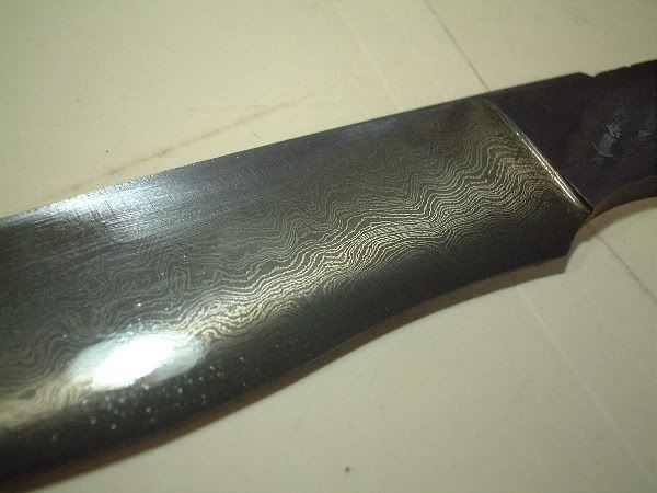

This is 405 layers of 1084/15N20.
Will be mated up with a hot-blued mild steel "Lazy 'S'" guard, stabilized "feather" walnut handle and the blade will be hot-blued as well.
