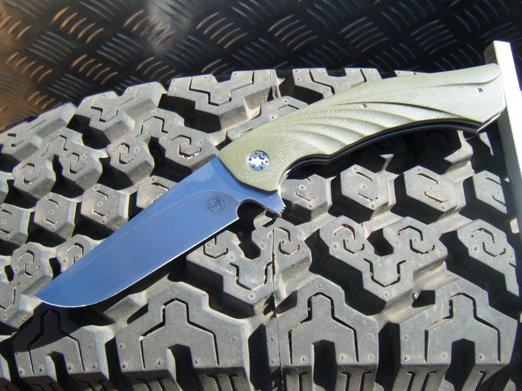

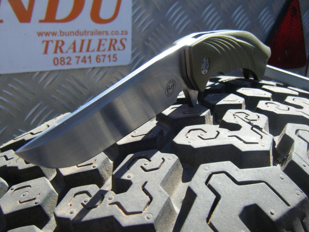

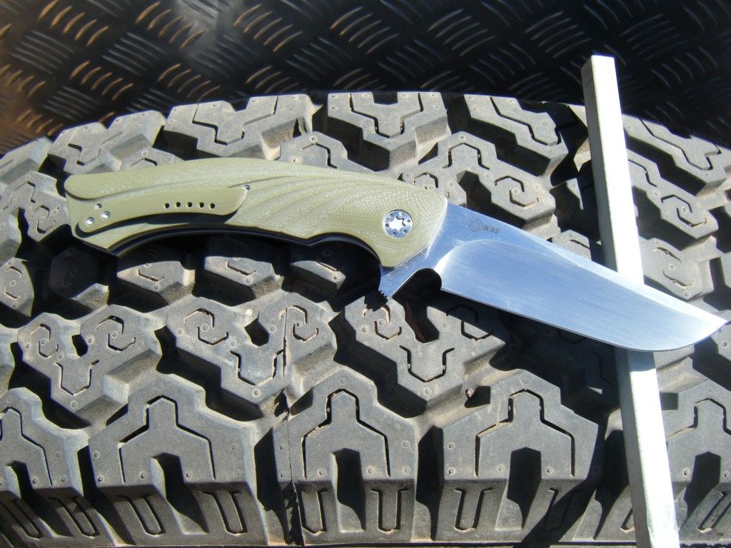

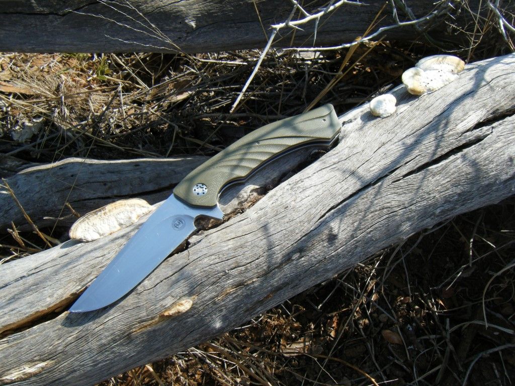

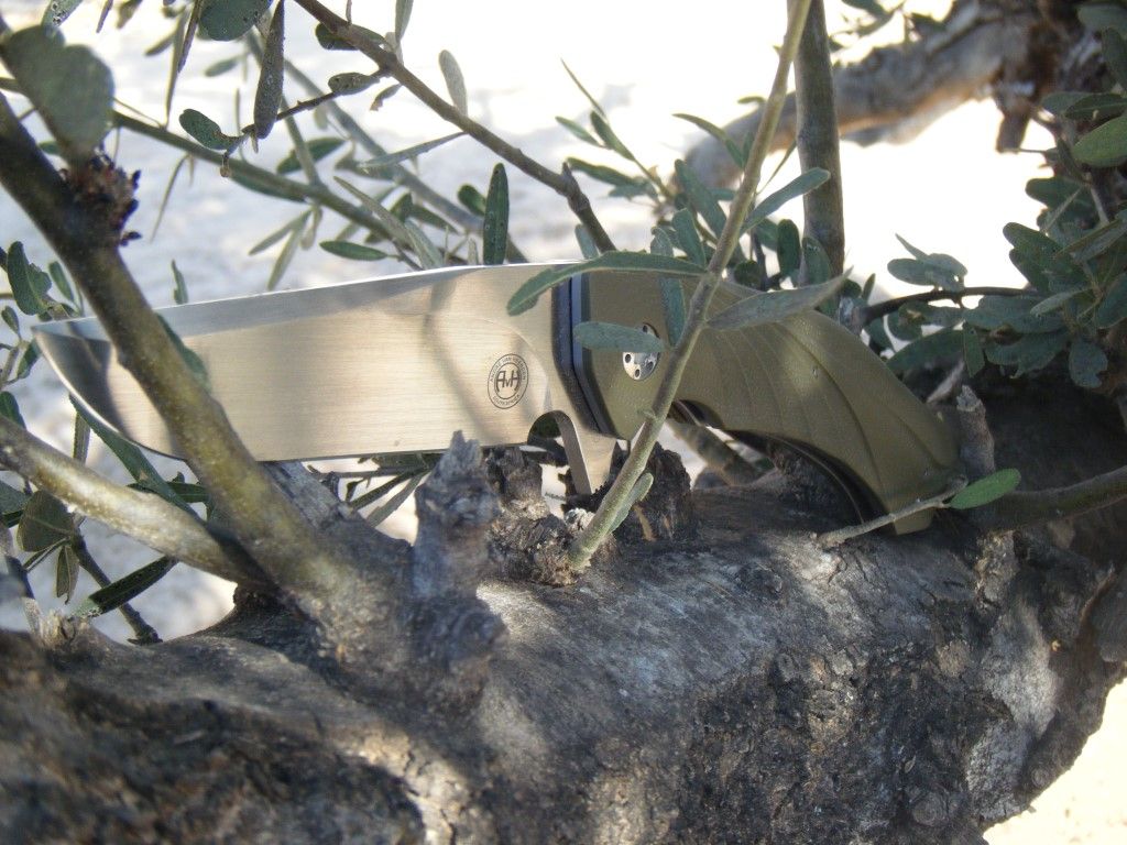

Here are some glamor shots:

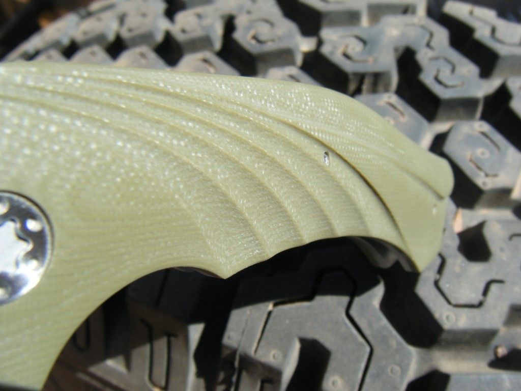

Handle: 3D machined G10 handle (dont really know how to describe it)

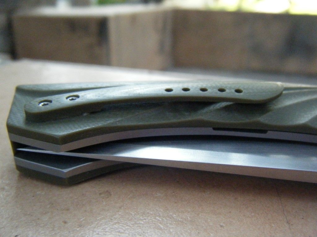

G10 Backspacer, I am not a fan of flow through construction, IMO it does not provide any benefit in use.

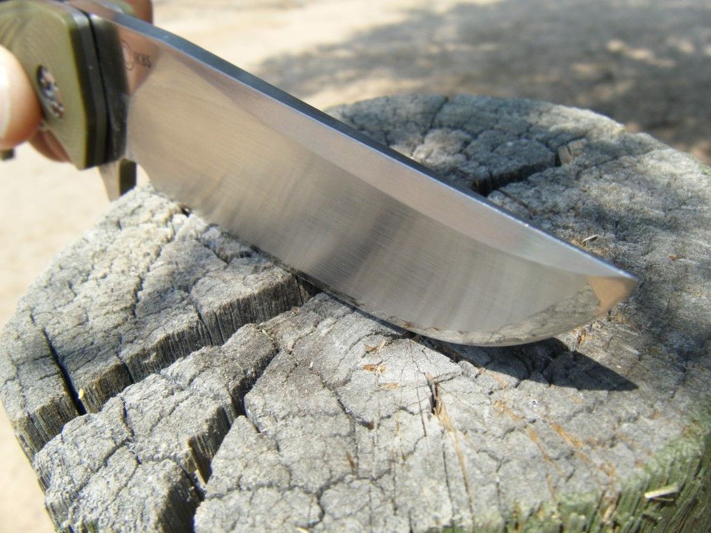

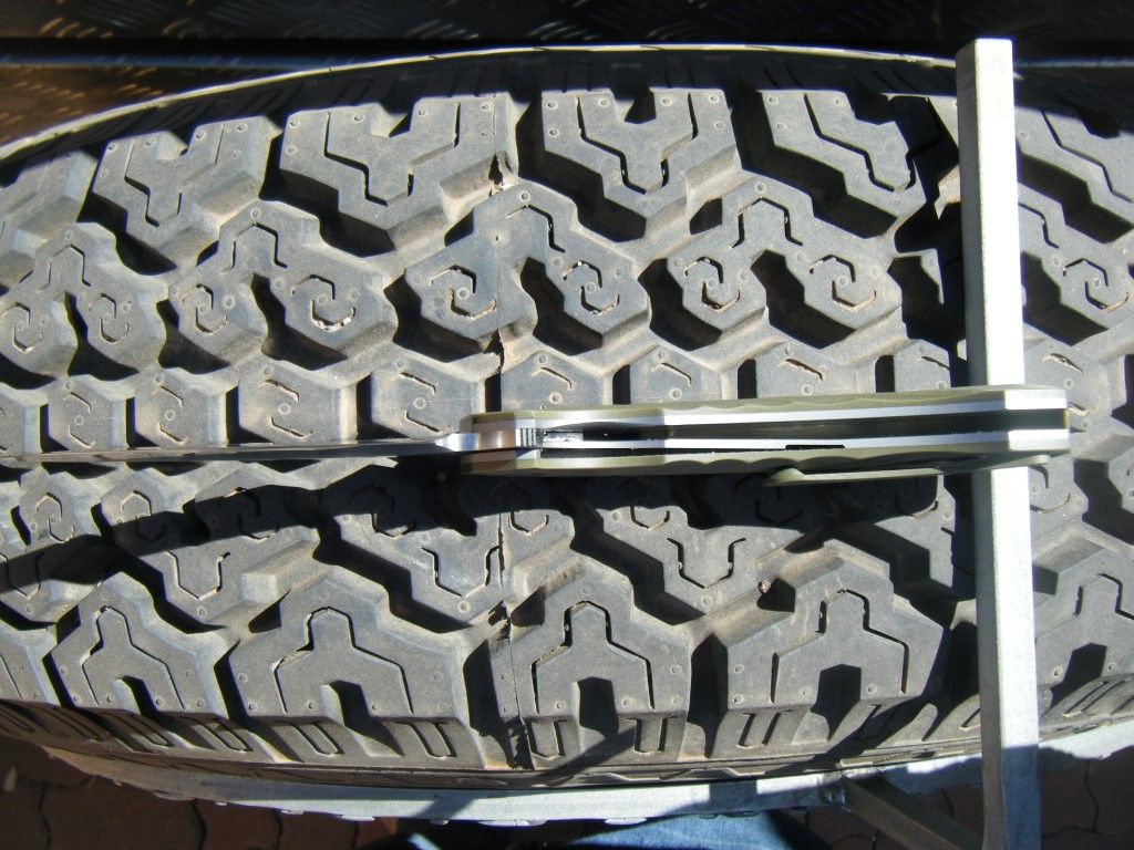

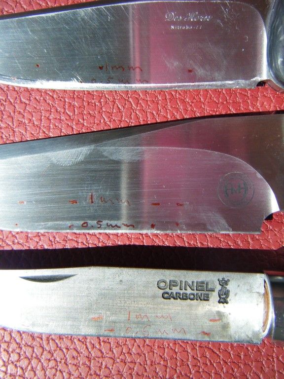

Deep hollow grind (approximately 4.5 - 5 degrees per side and the hollow drops below that and this is considered a rather strong (thicker than normal) edge.

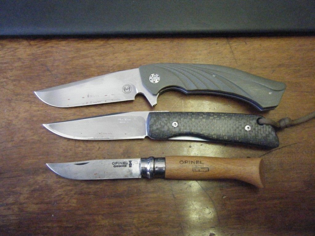

Compared to a Opinel No 8 and my Des Horn Imvubu with another robust grind. It should be noted, these robust grinds are significant thinner than a stock Paramilitary 2 or Military.
15 degree per side edge from the maker.
Nicely finished edge for slicing aggression.

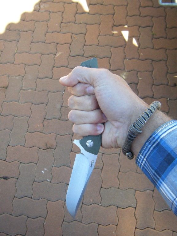

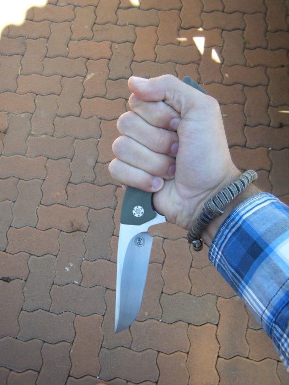

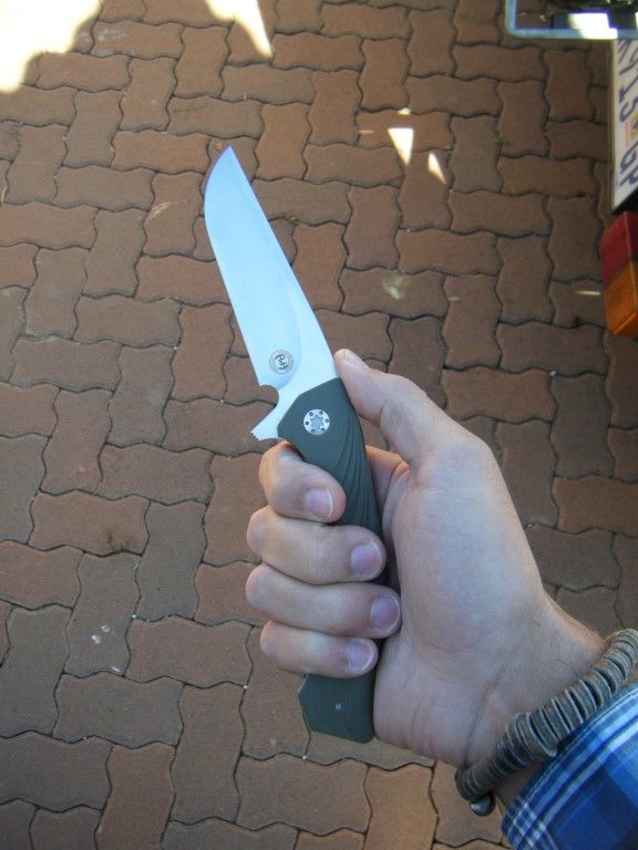

Grip is good and feels secure in the hand in multiple grips.
Contoured handle provides a nice feel in the hand.

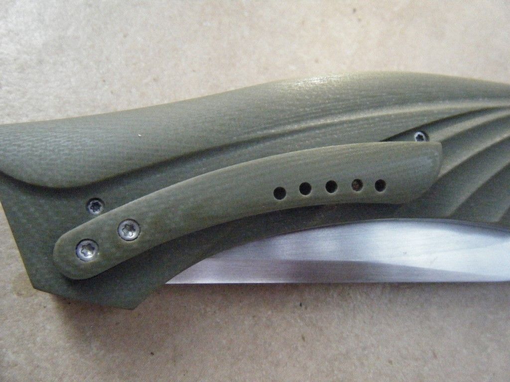

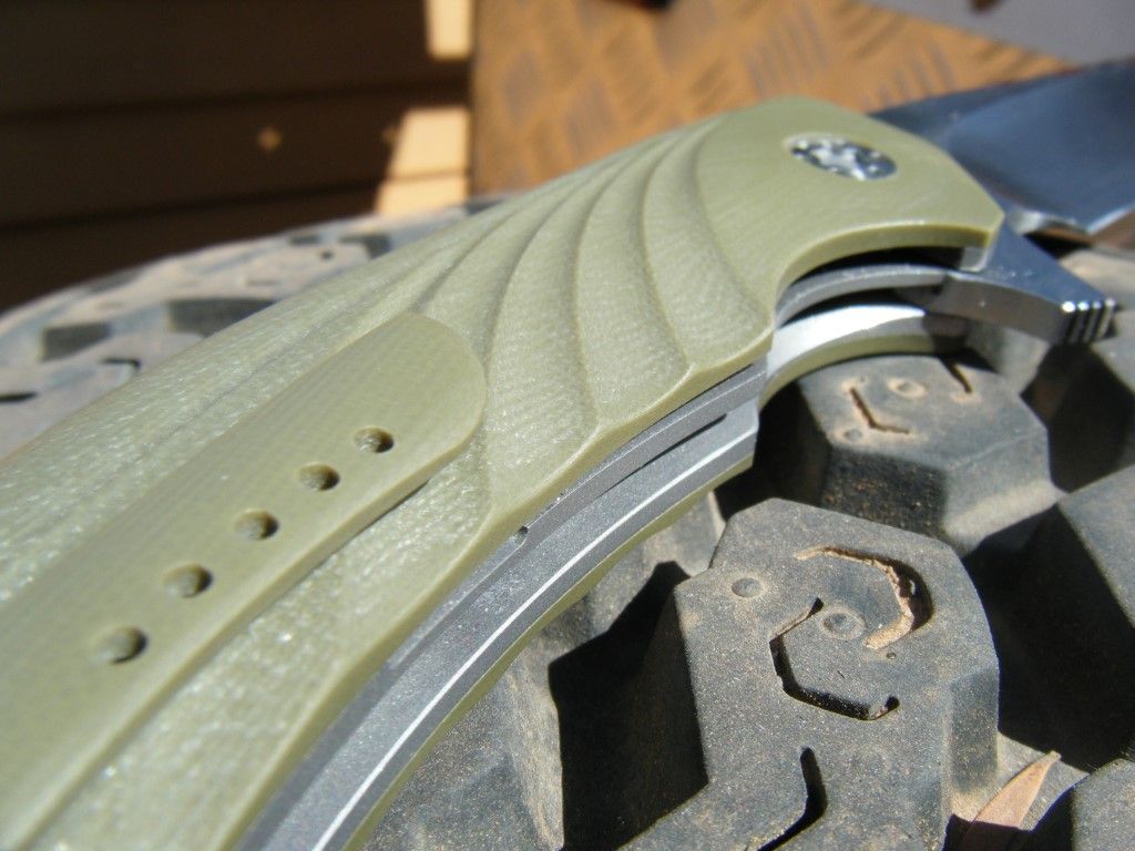

Since the clip is rounded as with the handle it has not formed a hotspot, really enjoying the clip design, however, since it is G10 I am wondering about its durability, should be interesting to see how it holds up in the long run.

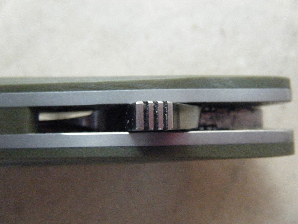

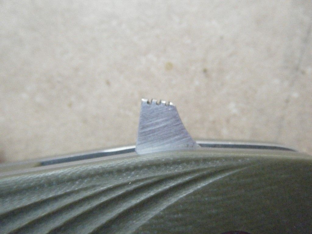

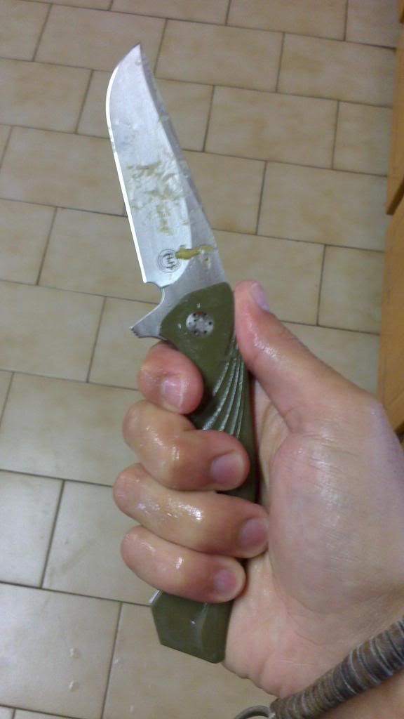

No jimping except on the flipper. Jimping is not required IMO on this model as the handle design offers enough security even with hands that are oily:

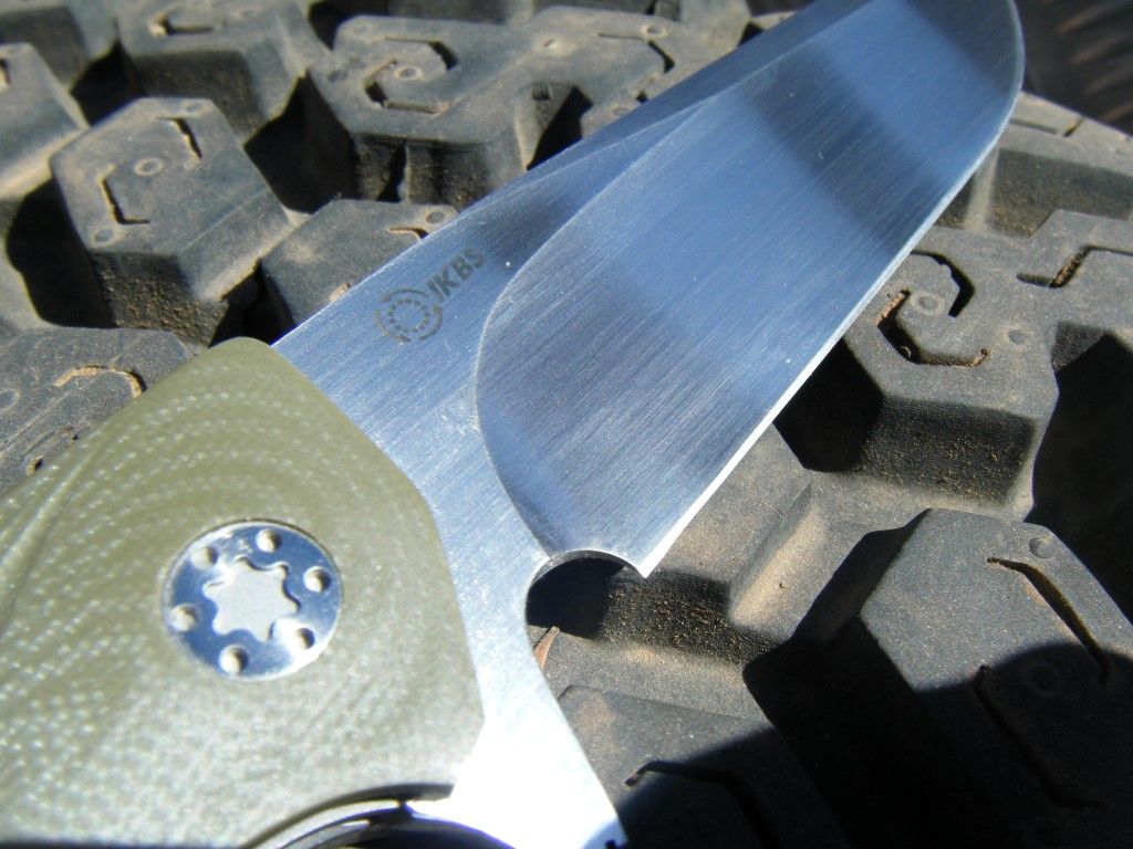

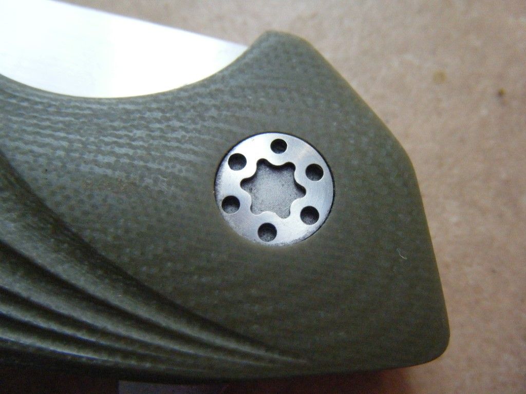

Detail on the Pivot, I believe these are made by the maker.

Not a flow through construction, once again, I like that.

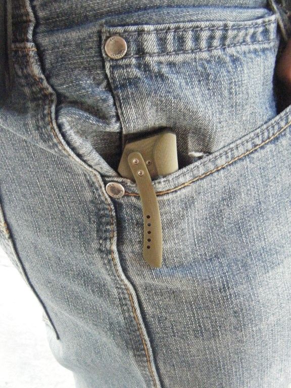

Rides a bit high for some in the pocket, but I have no issues

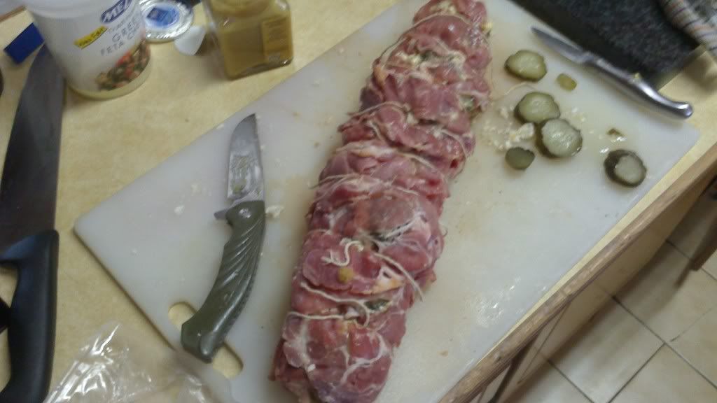

Stock testing:
Initial edge is a slicing orientated edge. Will push cut newsprint at 45 degrees.
Shaves arm in either direction with little snag no burr on edge

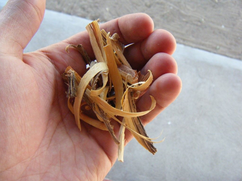

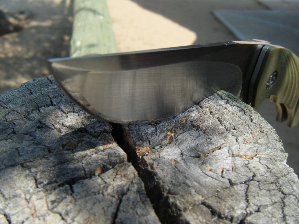

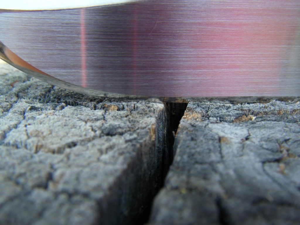

The knife performed well on hard dried out wood with moderate pressure outperforming a stock Mora blade.

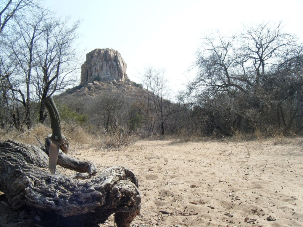

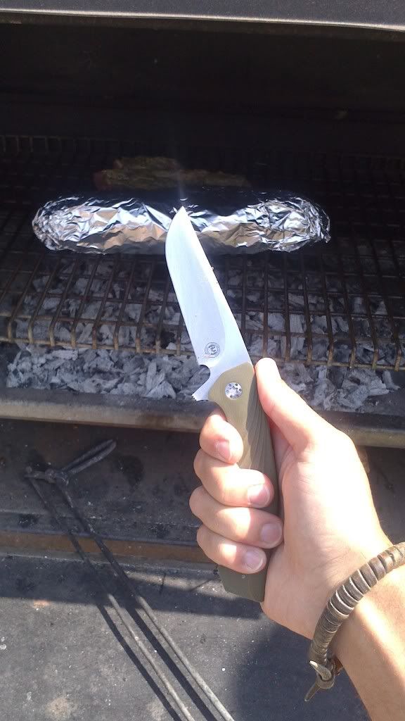

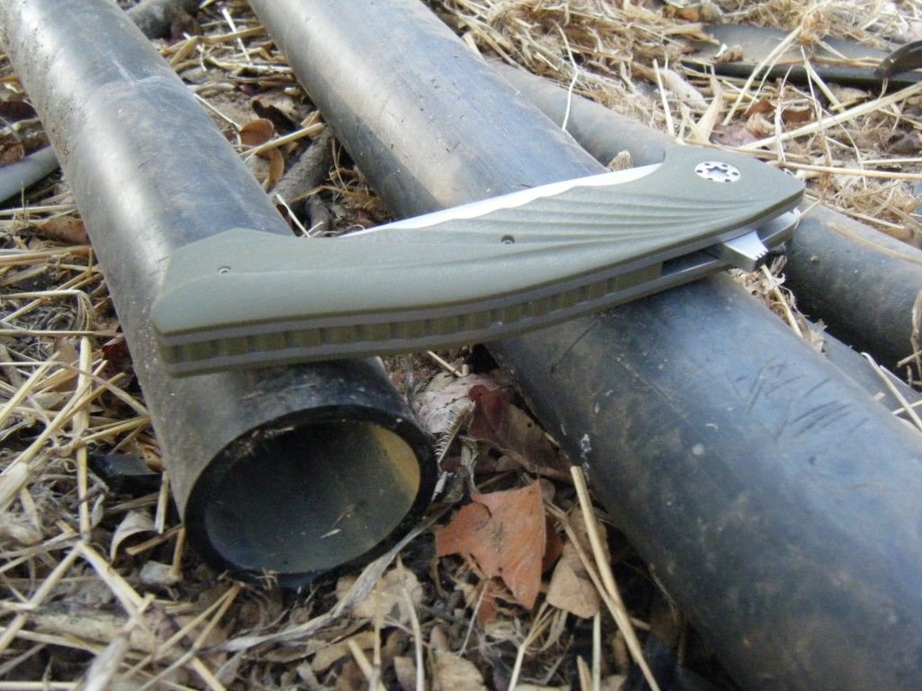

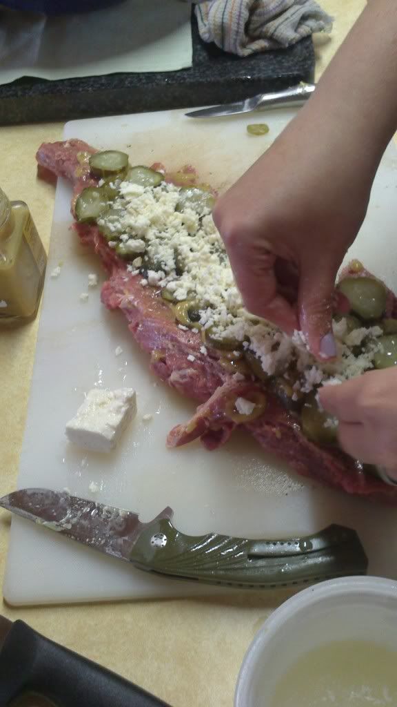

Video and pictures of some use.
[video=youtube_share;ytahWLrwdqQ]http://youtu.be/ytahWLrwdqQ[/video]

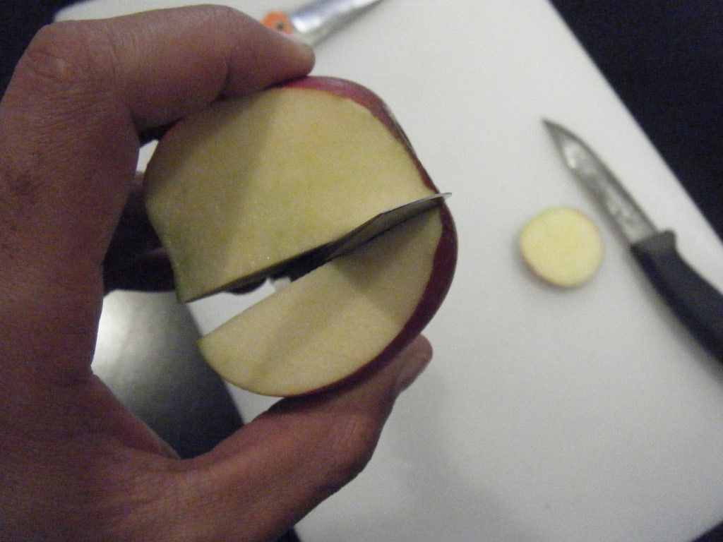

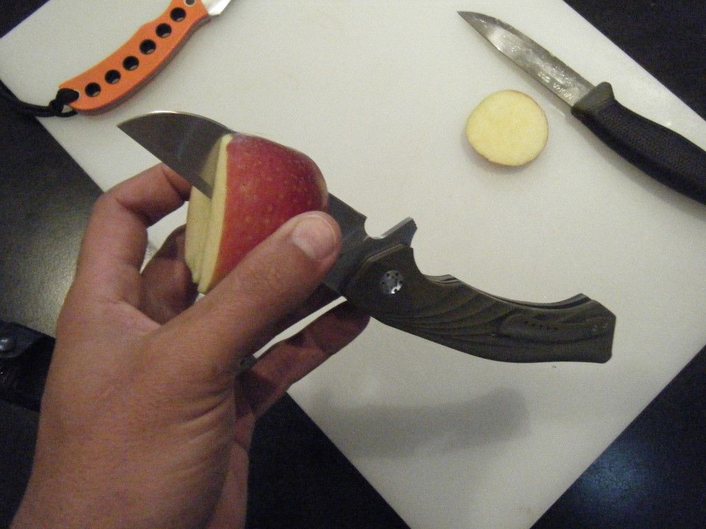

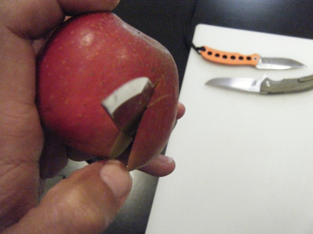

Did not crack open hard food such as apples, potatoes etc. Clean cuts.
vs cracking an apple like the Mora
