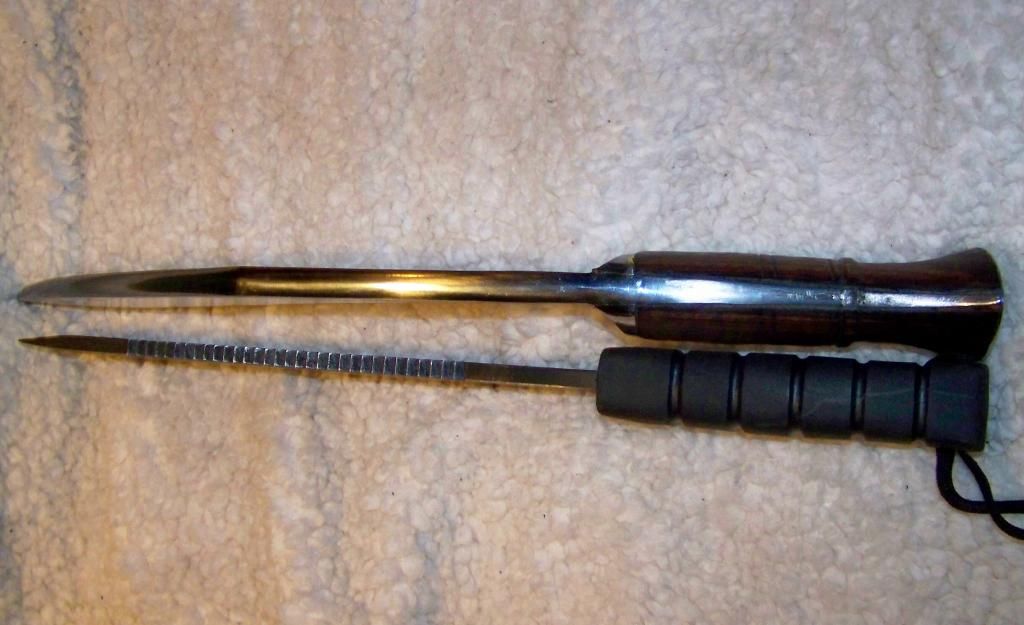

I can't give you a spine shot of the others but here is my Bonecutter next to a 1/4" thick chopper.

Yep! would like to keep my parts! Well you know i havent even tried splitting with it yet so dont change your thinking process yet. I just assumed it would be too light. I should give it a chance...I have some logs outside the front door now so Ill report back to ya soon. As far a batoning I would think it would work well but id would have to revisit the "what to do and not to section" before i go beating on it. Not sure how the hidden tang would fair? Im confident the blade would do well. I know this has been brought up before so wont get into it yet. will get back to ya hopefully tonight maybe with pics if I dont get too lazy!
OK as promised! I didn’t mean for this to be a chop…or should I say Split-off so take it for what it is. Special thanks Bawanna for enlightening me on the powers of this little beast!
Here are the victims: Three well dried and baked oak logs. I tried to pick ones without knots but the small one does has a knot. Split/photo time less than 20 mins. Oh well let’s see what happens.

My overall thoughts on this short session with the AK is that this knife is capable of more than I had given it credit for. It mandates good technique to get these results. The profile of the blade with substantial meat behind the edge prevented it from deforming like some other flat ground harder edged more acute ground blades I have used as seen in the above photo. I dont claim to be an expert but I use knives EVERY day and know what works for me. Hope someone finds this useful.
