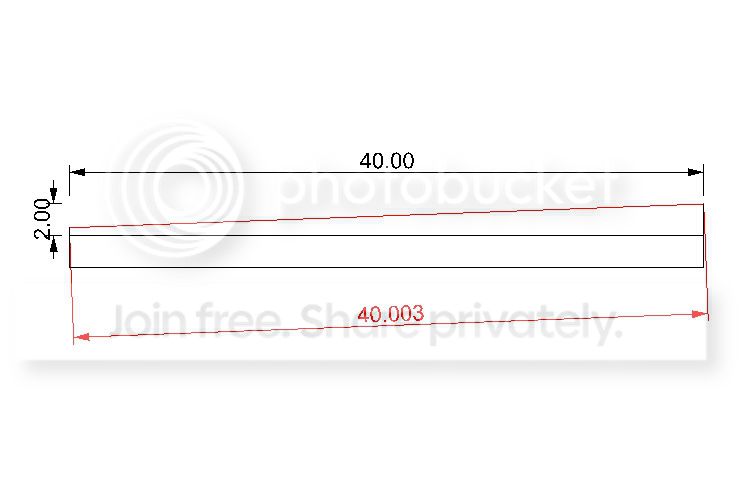

the angle of the main grind depends on the depth and thickness of the blade and where you start it. its just a little trig to figure out what you want to grind it at. think of the grinds as right angle triangles mirrored to make a cross section of the knife.

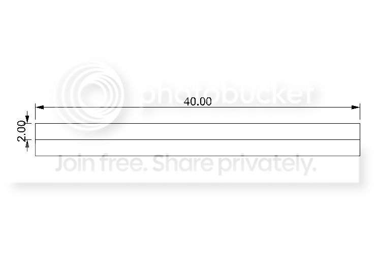

I dont know your files dimensions but lets say it 4mm thick and 40mm high, I am using metric just because of the simple numbers. so think of it as a pair of 2mmX40mm stacked rectangles
I will use a grind that goes to the spine for this example just because its earier. You need to leave about the thickness of a dime to protect the edge during heat treating. that would be aprox 1mm, so you know that your triangle has a 90 degree angle with one side of 40mm and one side of .5 mm. Using the Pythagorean theory of A squared + B squared = C squared you can find the length of the side hiden by the material that you need to remove.
So .5 * .5 + 40 * 40 = .25 + 1600 = 1600.25
to get the leangth of the hypotenuse that the square of 1600.25 which is 40.00312487793922
With those numbers and the one angle of 90 deegrees you can either crunch out the numbers your self if you trig is good, or do like I do and use the internent to figure it out for you:D
Do the main gring on this example is: 2.15 degrees
