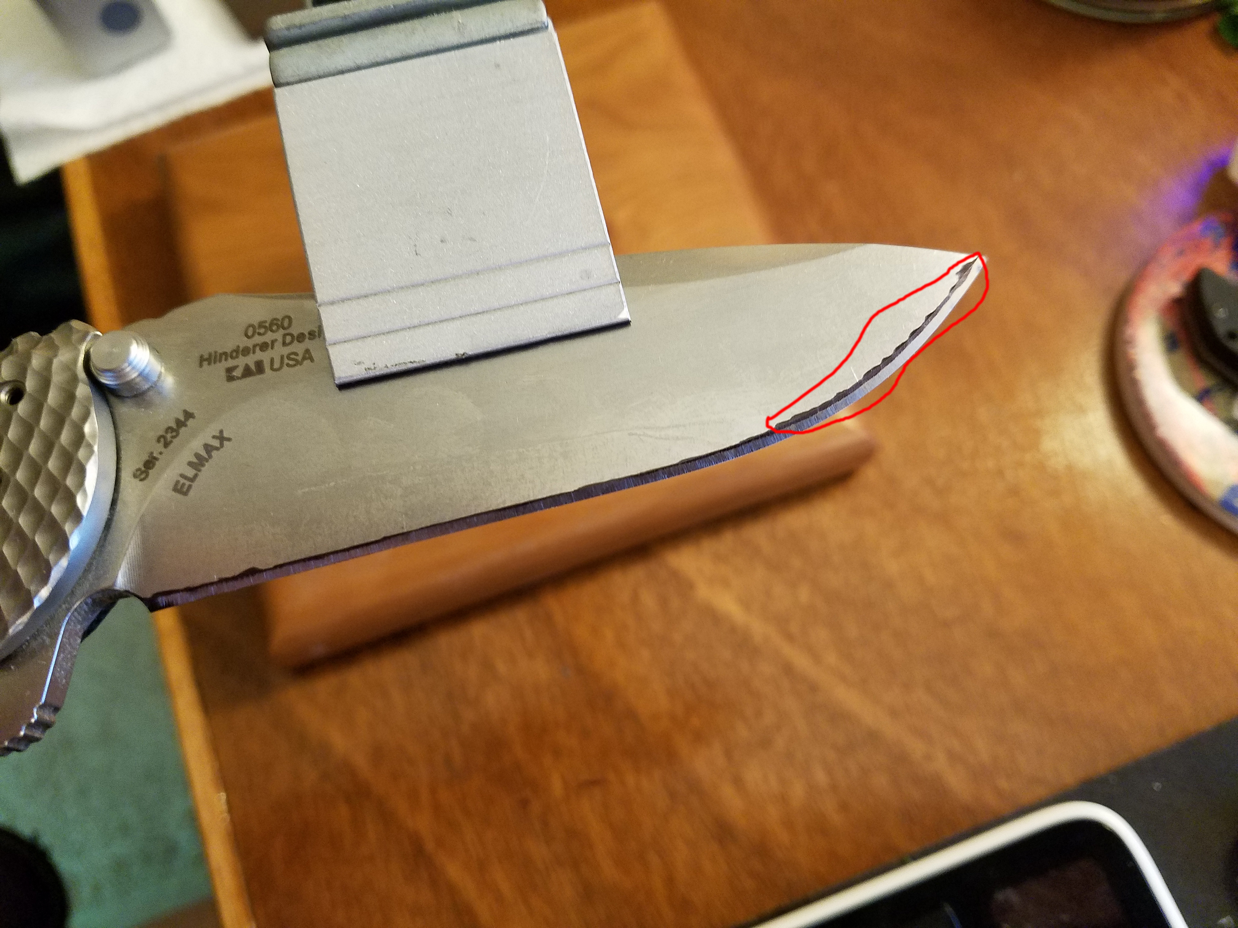

Sharpening my 0560 here on my KME and after a few passes with the coarse stone, I noticed the sharpie is off all of the edge except for near the tip, to the point of if I decrease the angle any more I'm going to be sharpening the non edge portion of the heel of the blade. Here is a picture to show what I mean:
What do I do about an uneven grind like this, hit the whole edge or keep it at this angle where it won't touch that higher part?
That bevel looks pretty good to me... it looks like you're hitting the edge all the way down and the bevel looks pretty consistent width wise. I think I'd sharpen it as is. But if I'm not seeing it right and you want a lower angle toward the tip, clamp the knife closer to the handle.
Looks good to me, too. What was the angle? If it was lower than 21 DPS, I would say stay there. The even bevel will be corrected eventually as you sharpen it.

From the picture it looks good to me too. Usually that part of a blade has a steeper angle. I cant see needing to go more shallow.
You could move the clamp position closer to the heel of the blade. That will increase the distance to the tip region and effectively lower the angle a degree or two.

AngleCube is saying about 21.8 degrees.
Thanks guys, guess I'll leave it there and see what happens.
