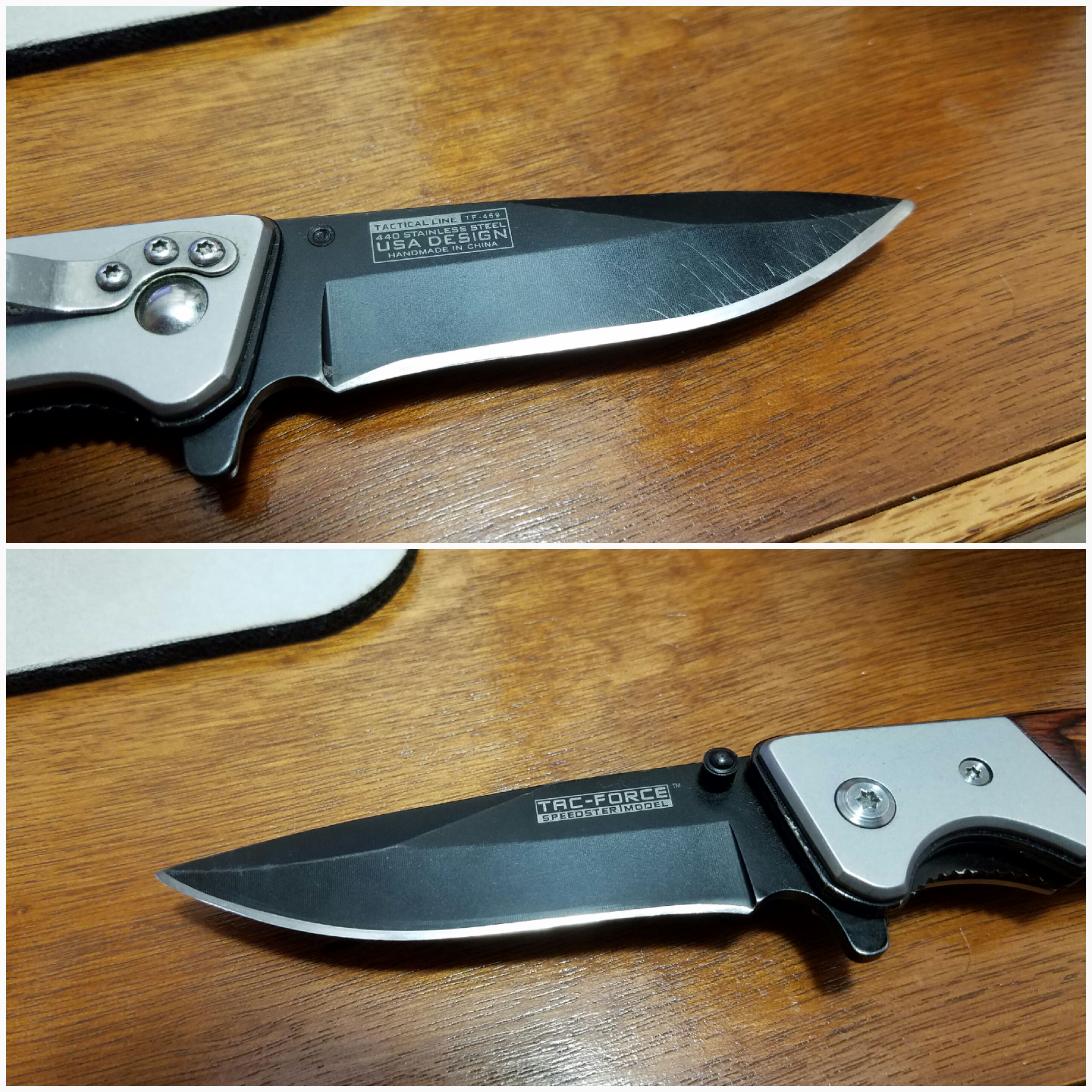

Ok, so I shouldn't just find the angle of one side, get the burr, then flip it and assume that since the angle of the KME hasn't changed that I can just go crazy on the other side because the primary angle may be off too which will lead to a higher bevel on that side? That could explain why this happened on a crappy beater knife I was practicing on, pretty sure I just got one side to a burr and then flipped it and just went nuts until the other side got a burr, resulting in a much higher bevel:
Sorry for all the questions, sharpening 100% correctly has always been something that eluded me for some reason. I can get my knives to easily shave and slice through telephone book paper but little things like this (which isn't really that little) always snag me. Just when I think I have the hang of it something like this happens and makes me wonder why. These were my rough notes I made after once again trying to figure it out and watching a couple youtube videos:

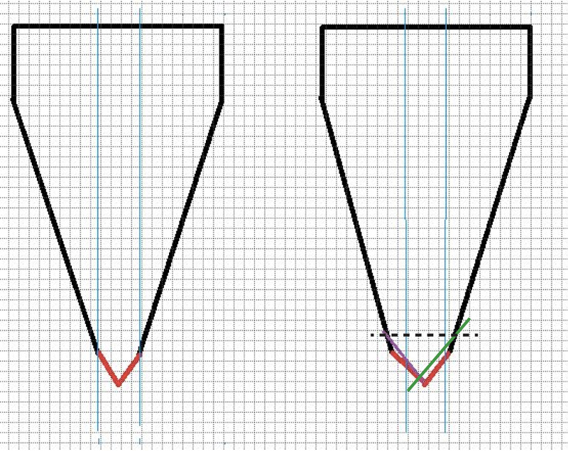

That's precisely it, here is a cross section diagram I just drew. The one in the left is the ideal grind where primary bevel is perfectly matched and the gives you perfect secondary bevel. In a perfect world I suppose it does happen.
The one on the right had side the purple line is what happens when you stayed the same angle and the primary bevel is off. The only way to make the bevel the same on each side you need to compensate with a more obtuse angle
As you sharpen the narrower side little more than the other, the bevel width would become similar over time at the same edge angle, as indicated with the green line.
Modified from the image of wiredbeans.

Yes the solves the issue as well but now your apex is off center and it becomes right handed grind. There is such a thing as left handed and right handed grind.

Since I use Edge Pro Apex, I would rather like to have the same sharpening angle for both sides than the centered edge. Also the aesthetic of even bevels would satisfy my OCD, as I cannot perceive the centering of the edge.

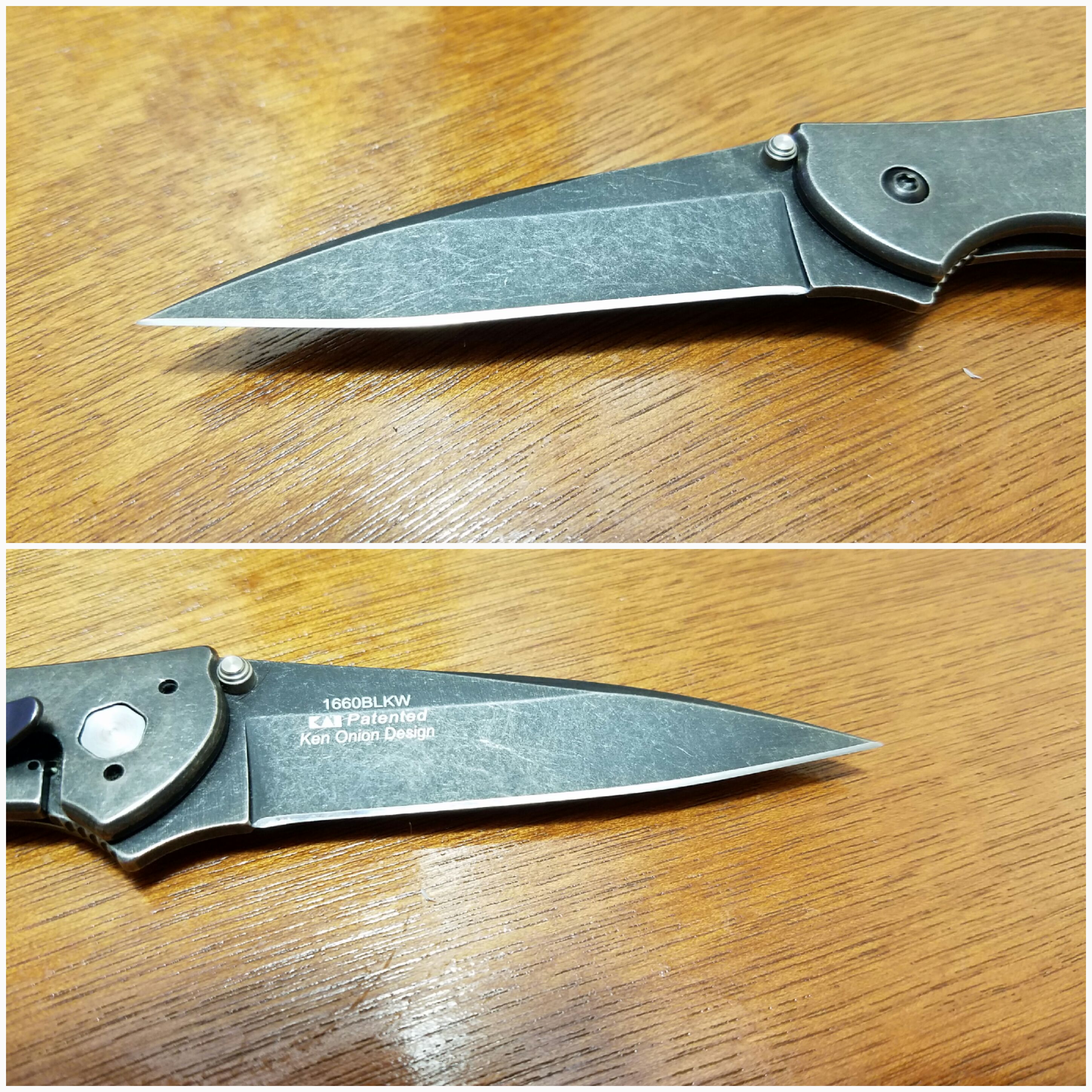

Well as usual, I got my Leek sharp, but it's not pretty and the side appears to have a different bevel slightly. I adjusted the second side so the sharpie wore off and my anglecube was telling me it was around 17.5 degrees on that side compared to about 21 on the other. When I flipped the knife back to the original side and tried the sharpie trick the marker wore off at that angle too, so I just left it alone. If I'm supposed to tweak the angle every single time I flip it to account for the manufacturer's flaws I'm not doing that, so I guess I have to live with a slightly off bevel if that's the case.
I mean it cuts Ss out of telephone paper so it's decently sharp, but I just don't think I'll ever master this fully. At least I got both sides equally sharp and throughout the entire length of the blade, that was my old issue. I never felt for the burr along the entire edge so carefully before but now I'm getting the hang of it. Once I switch to my fine stone it's almost impossible to feel anything though so I may be able to do better there too.
That looks very good, any one would tell that's a good looking edge! Especially the tip! The trick is like you said: have the consistent apex from heel to toe and straight.
I do this before I sharpen anything: open the blade fully, put the spine side on the table, the handle will most likely match. The apex is now facing up. Use the angle cube to find out the angle on the primary so I know how to proceed with my intended inclusive angle. If I'm aiming for 30 inclusive and the primary is off by 2 degrees then I would do 14 and 16 instead of doing 15 on one side and 17 on the other to compensate the bevel width.
