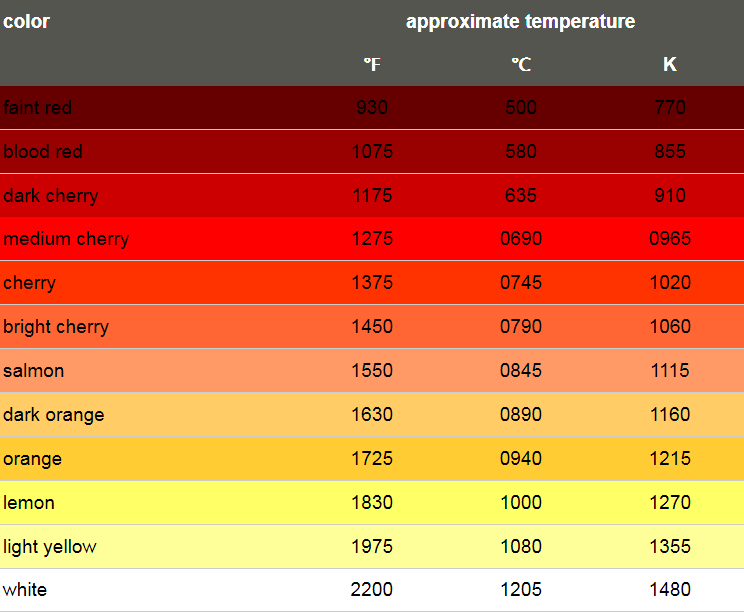

so dark orange

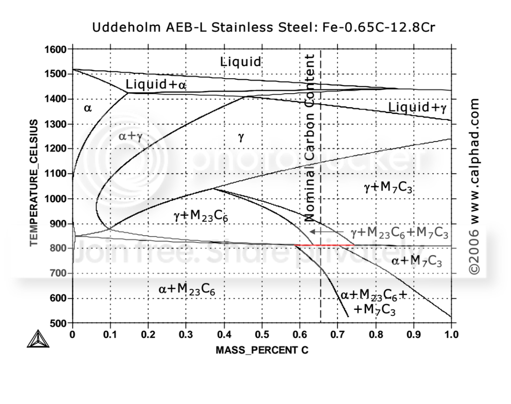

I really hate to expose my lack of knowledge, but can anyone explain that phase diagram? Below is the diagram.
It is a bit hard to explain it all, because a stainless steel chart is more complex than a simple carbon steel chart. The symbols are for alpha iron, gamma iron, and metal carbides. The lines are the points that they change phases and structures. The area between two boundary lines is a zone. The important zones we are dealing with in stainless HT are the alpha/gamma zone, the gamma zone, and the alpha + M23C6 zone.
By using the chart you determine the temperature it takes to get a certain structure and how time affects that change.
In carbon steel the main players are ferrite and cementite, austenite, pearlite, and martensite. In stainless, these can get combined and be in different forms.
