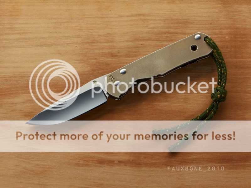

I just ran across this thread - very interesting! This 1999 Small Regular was anodized golden by the previous owner. I carry it a lot and like the knife more than the color ;)

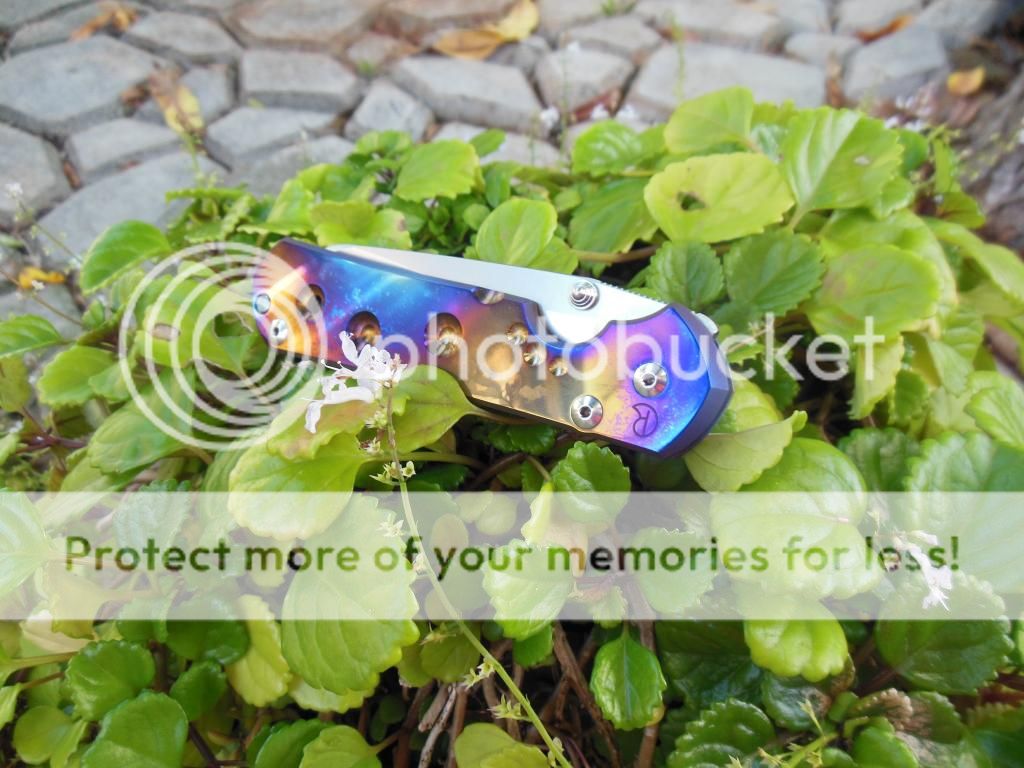

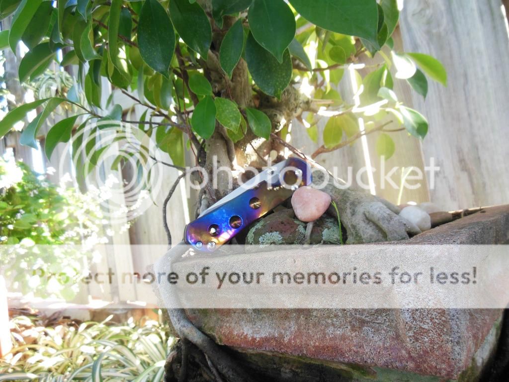

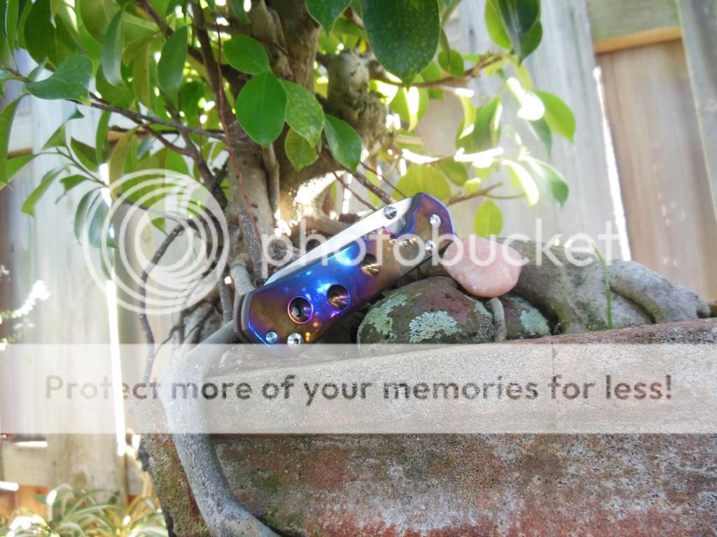

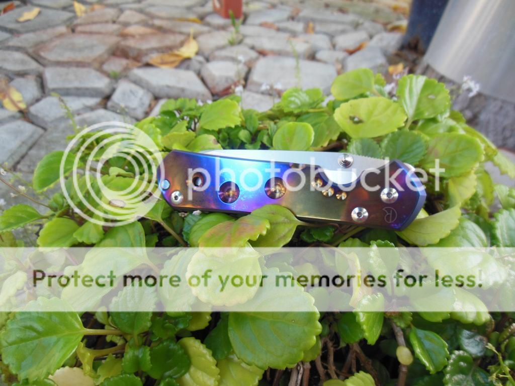

Since I finished for now, on my Insingo's mods, finally coming over to join into your started thread on the subject of anodized CRKs.
First off. It is not meant to compete with you or your business - please don't take it wrong!
I do it only for myself and my own personal satisfaction - machining is one of my many passion. :)
Posting these solely for the benefit of sharing ideas to whoever can benefit from:
Keep on modding! :)
Victor, you and anyone else are welcome to share here! Your Insingo looks fantastic! Excellent work my friend, mods, and anodizing alike! My business is strongly rooted now, and competition should be welcomed! I'm just a guy who loves doing what he does, and making others happy with what I do. Money is secondary!! Please share here whatever you want brother!
Edit: I only post the CRK stuff I have anodized in here, so it's not my services thread! Did you anodize the lock side as well?

I'm not normally a fan of holes/divots in the handles but what you've done to that Insingo is very stunning.
I like that you used different sized holes and somehow kept it random but in a pattern all at the same time.
That anodizing is quite beautiful to me. I think that it kind of looks like a lightning storm, which would be a pretty cool name for it that you can feel free to use ;P
Seriously though, thank you for sharing that with us all.
