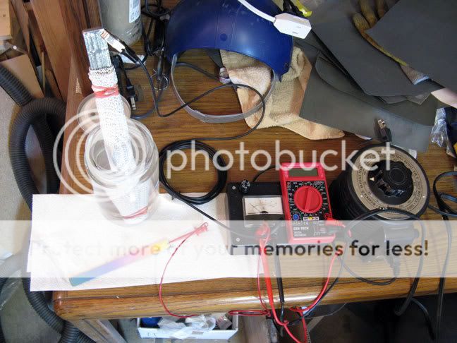

I found what I was looking for. It turns out that there are many different terms that sellers on ebay use to describe variacs (variable transformer, power supply, staco, etc.) I wasn't finding the variac I needed because my search terms were too narrow. I ended up searching for "0-140" and that turned up three variacs that I had not seen before.
I ended up purchasing a Micronta 0-140V 500W 5AMP variac for $65. It's on it's way to me now. I am going to start gathering the other supplies I need.
I got everything I needed at Radioshack except for an amp meter. Cost about $50.
I'll post up some pictures here when I'm done.

Here is a link to a post I made to an earlier thread, entitled "Don't waste your time like I did!", where I listed all the parts I used to make my anodizer. Mine machine works, but I concluded that I would have been better off buying that nice little unit from Circuit Specialists.
Now where's the fun in that? ;)
I saw your advice and you're probaly right. But if I can get a couple extra colors with the home made power supply, it will be worth it to me. If I bought the cheap DC power supply, I would be wondering what I was missing out on.

I got the anodizer running a couple weeks ago and just got a chance to take pictures. I'm going to modify it some more and improve it in the future. It's doing the trick now.
I found out that the green colors I wanted are at around 85-100V.
