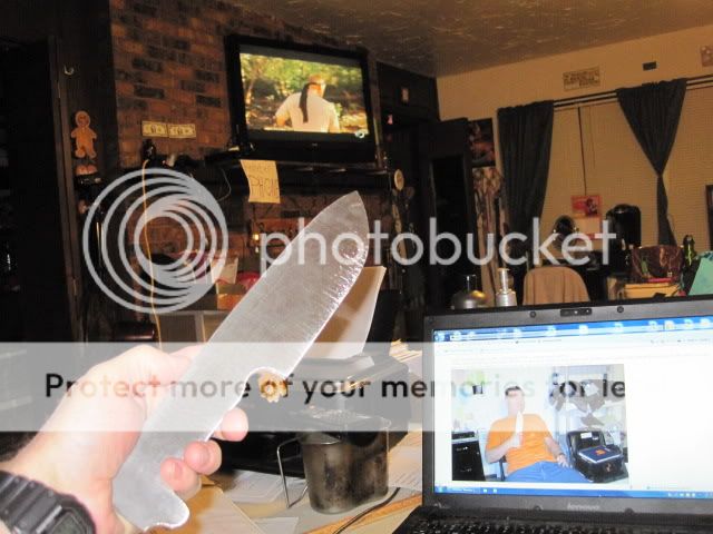

Hi all,
Great looking design, Frank. I think you have a winner there with it.
I have been handeling that blank off and on and I bet I have 2 plus hours just holding and going from one knife postion to the next lol.right now as i write I am watching Dual Survival Yep i am holding your knife to lol
going from left hand to right hand. This is a pretty comfy feeling in the hand knife so far. I can hardly wait to
get it done.
get it done.
Ohhhh you are sooooo bad making the anticipation all the worse!!! Sitting there, holding my knife, watching TV together. ARRGGHHHH!!!! lol - just kidding 'round bud!
Since you went through it with me over the last 5 months you know how i've changed things around. I gotta say though the handle was hardest. It seems soooo different from all the "barrel-shaped" handles i had a hard time *not* just drawing one of that style. However, after i spaced the notches and curves to fit my paws (as well as including the "bird-beak" for the rare/occasional chopping), it seemed the most comfy of all my mock-ups.
