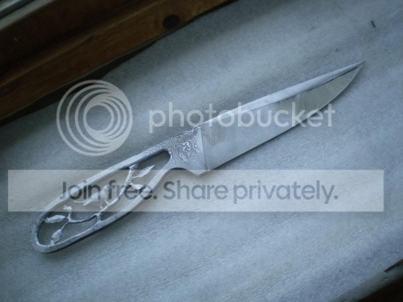

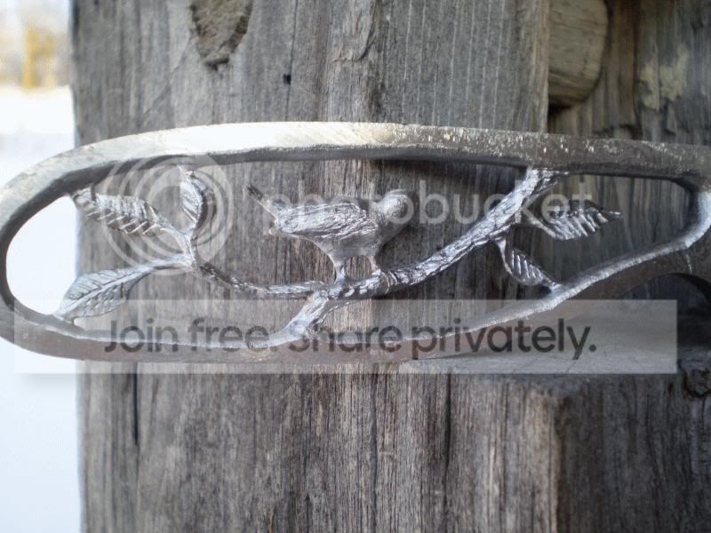

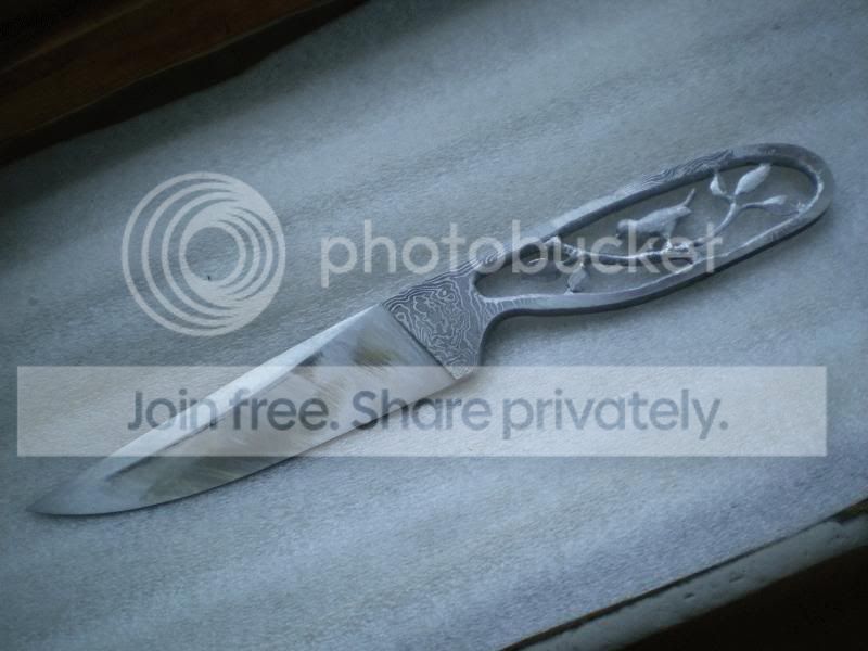

Well i got around to start another carved handle on a piece of damascus.
This one is dedicated to Ray Richard. When i made the last ones a couple of years ago Ray said now carve a bird in a tree so i thought what the heck why not.This brings a whole new meaning to stock removal.:D Here's the knife so far. Thanks for looking i will show some more pics as i progress.
Bob
Thanks folks i still have to texture the bark and do some graver work on the bird and leaves then it will be clayed up and heat treated. If it survives then to polish and etch.
More pics to come.
Bob
So far i have used lots of drills to reduce the stock then dremel and files along with a jewelers saw and lots of blades.

Thanks again guys. Patrice if you can do what you do all day this is relaxing;).
Bruce i'm not realy sure what type of bird it is but blue bird sounds good to me so it's a blue bird.:D

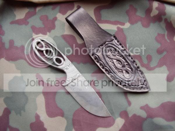

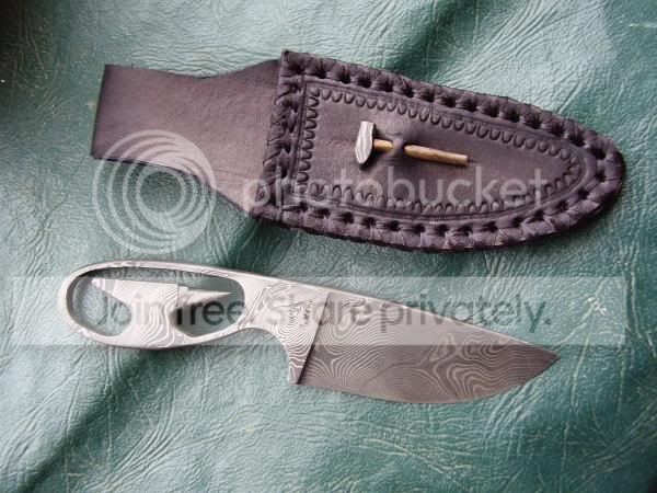

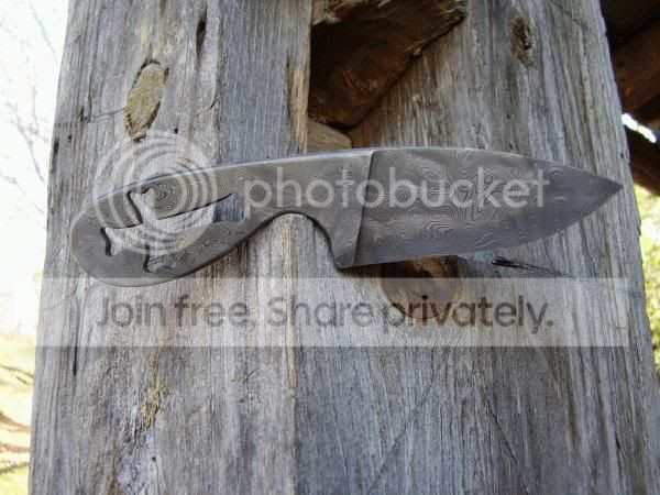

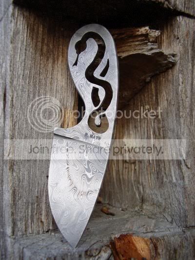

do you have pics of other knives that you have done this way? this one is turning out beautiful! i was curious though, do you leave it like it is when done or do you fill it with as clear epoxy for a handle?
These are the only other carved handles i have done. Yes the handle will be left as it is but rounded and smoothed up .
Thanks Bob
The one with the anvil is the most appropriate knife I have seen as a gift to a knife maker, I saved the picture when you first put it up.
